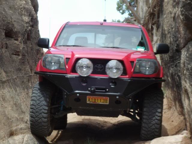

    damn looks like you had plenty of room...thought the 2nd gens were tighter of a fit through there...

    It was tight but plenty of room. The tightest place I found in Moab so far was in one spot on 7 mile down by Merrimac Bute.

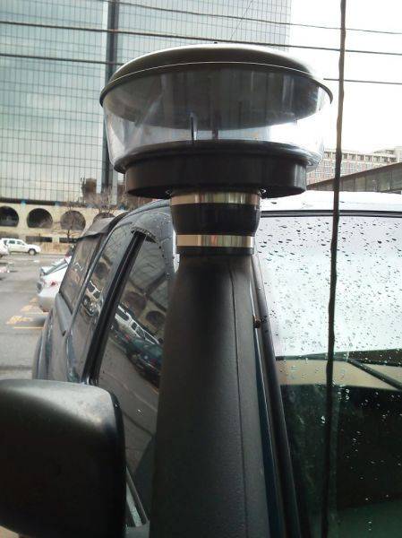

    no more water in the snorkel on big storms...finally got a nice fitting coupler to get the donaldson to fit better..
    spectre 4" to 3.5"
    this \/ could have been avoided driving through the recent snow storm last week if i had just put my pre cleaner on
    snow built up so much in the snorkel that water started to pool up in the tubing, soaking my maf and really messing with my engine..had to stop a few times to dry things out
  10. May 9, 2013 at 3:31 PM
    #1530
    la0d0g
    Jan 25, 2011
    #49903
    19,907
    running for the hills
    For crawling not hauling
    Hey Bob, n00b question for you. I thought you could turn the snorkel intake around, aiming it toward the back of the vehicle, during heavy snow/rain to avoid taking in the water and slush. Thoughts?
    And what is the precleaner you mentioned all about?
    Oh, and subbed :popcorn: nice truck :)

    When it snows, your supposed to turn it around :rolleyes:

    manufacture has a warning not to turn around backwards at highway speeds for the risk of creating a vacuum
  13. May 9, 2013 at 3:39 PM
    #1533
    NYCO
    NYCO [OP] go explore...
    Jul 27, 2010
    #40842
    19,126
    bOb
    Colorado
    Blue Betty - '06 TRD OR
    dents & scratches
    talked with a guy at cruise last week who is a multi-day racer in australia and a product developer for an off-road company who says i'd be fine flipping it around
    so idk...but i had bought the donaldson a while back but never had a good way to mount it on there...the prefilter was too large to fit snug on the snorkel tube
    saw someone else using a coupler to make a nice connection and finally found one that fits both ends snug
  14. May 9, 2013 at 3:40 PM
    #1534
    NYCO
    Jul 27, 2010
    #40842
    19,126
    bOb
    Colorado
    dents & scratches
    Should l put my air ram on backwards to stop water and other contaminates from entering the airbox?
    Yes you can, if your concerned about wash from a river crossing. It is not recommended that you run your vehicle above 25km/h with the air ram on backwards, as it causes damage to your vehicle.
    http://www.snorkels.com.au/g/33706/snorkel-faqs.html
  15. May 9, 2013 at 3:43 PM
    #1535
    NYCO
    Jul 27, 2010
    #40842
    19,126
    bOb
    Colorado
    dents & scratches
    Deflections may be caused by:
    1-Air Ram situated in close proximity to the bonnet/hood of the vehicle,
    2- Air Ram with a curved or foiled roof,
    3- Turning Air Ram away from travel direction,
    4-Where Air Ram design makes the air go back on itself at an angle greater than 100 degrees.
    If the Air Ram is turned away from the direction of travel, it will lessen the necessary positive pressure. In extreme situations, at higher speed, a vacuum may be generated causing irreversible engine damage! Incorrect Air Ram design may cause excessive induction noise, lack of separation and air blocking by vortex at various speeds. This air blocking will limit airflow. This is a common occurrence when “looks” take priority over functionality. If the Air Ram is moulded on the body of the snorkel (for aesthetic reasons) it does not provide particle separation, thus all contaminants need to be removed by the internal air filter. This increases the maintenance cycle of the air cleaner. Furthermore, this configuration may cause a vacuum into the snorkel, thus increasing the risk of engine damage.
    http://jeepinbyal.com/affiliate-products/airflow-snorkels.html

    Thanks for the info. So the precleaner/filter you mentioned is the Donaldson contraption?

    yup
