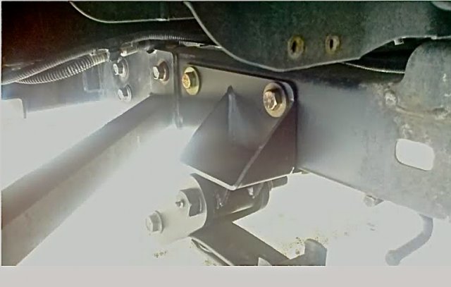

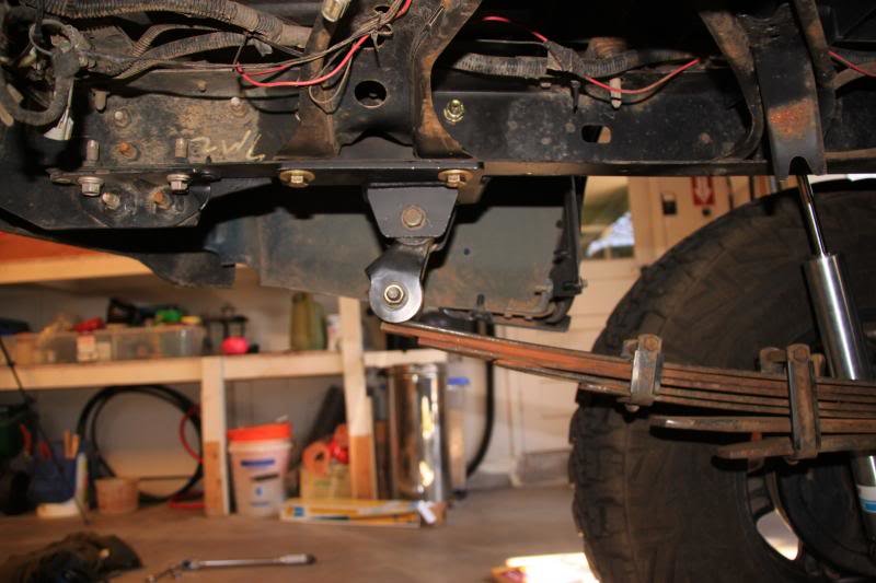

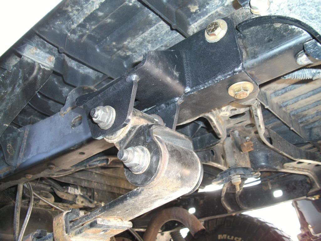

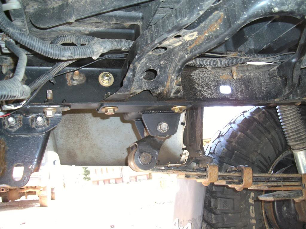

    looking at another recent run ATO did on the mount, it looks like they moved the mounting point back on the dakar set which they really shouldn't have
    mine
    the other set
    mine
    the other set
    working with adam now on a resolution

    yeap...hope to get this dialed in without too much more effort..
