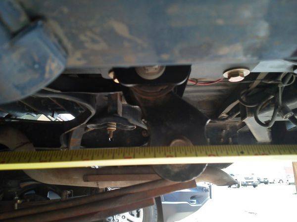

    if needed, we could move the upper shackle plates forward on the mount if that will help the setup.

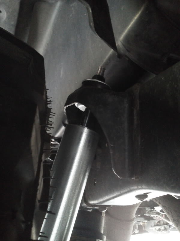

    shocks work good so far.

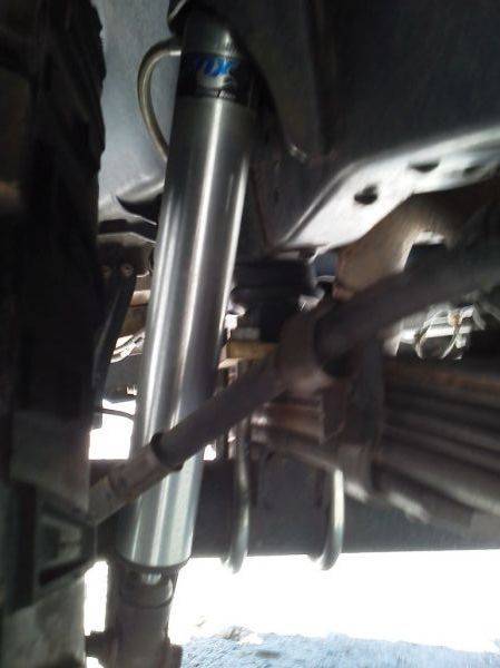

    when the axle was at full droop, the lower mounts lined up close. had to push the shock up slightly.
    i have to get out this weekend and test it out and see how my compression will be.
    the mount i had made for my bumps have a nut welded to the inside where i have the bump bolted into the mount. so if needed, i can take the bump off and add some spacers under it and lift it up. it'll be close.
    these were my foxes under full compression with the current bump height
    and the billies are about an inch longer compressed. that's about what i had left on the foxes at full compression. so i might have to add 1/4-1/2" of spacers in there for some cushion.

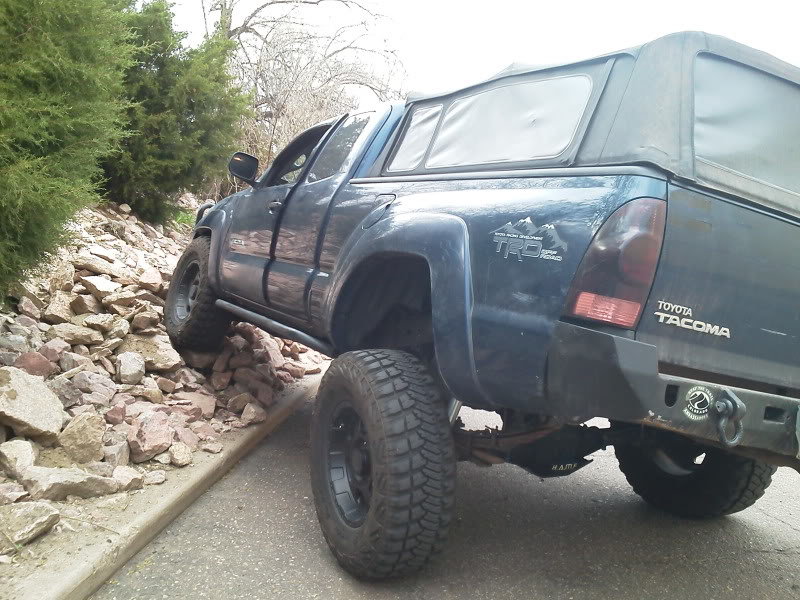

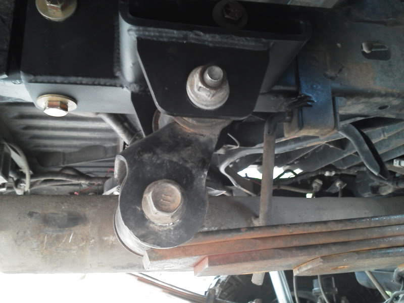

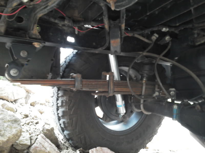

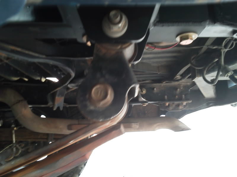

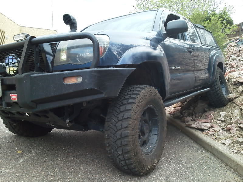

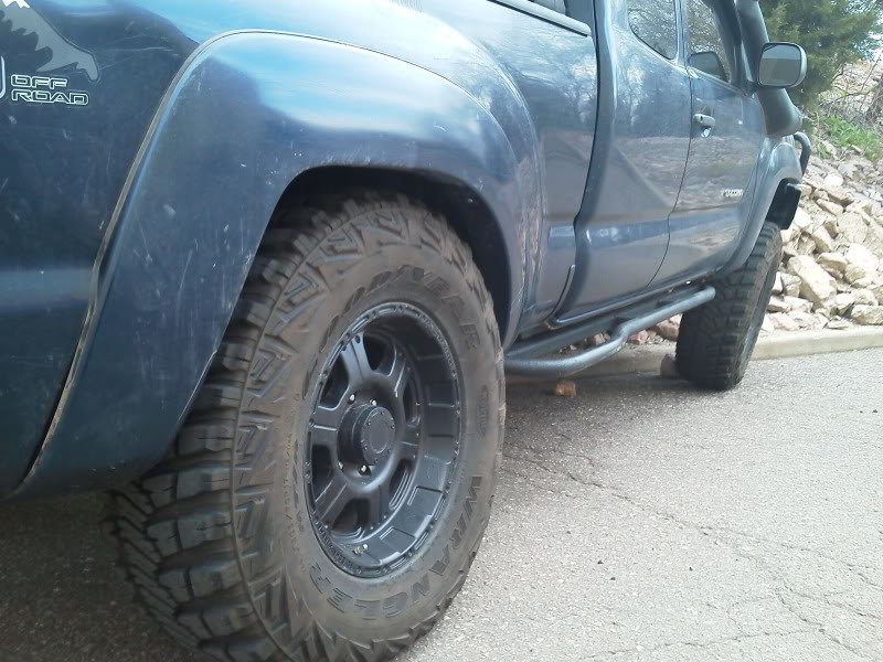

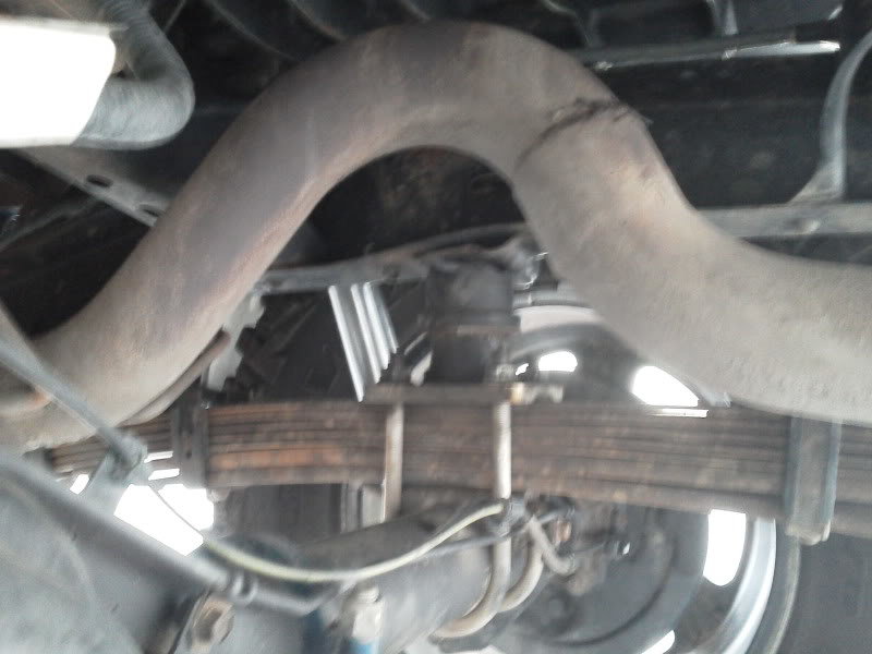

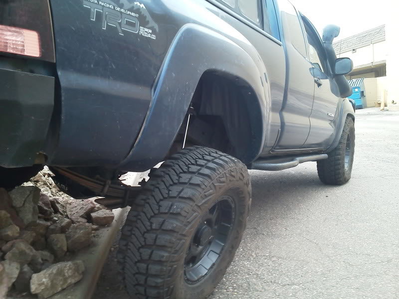

    so did some mall crawlin on the way home...eager to see how it performed as is..
    :burnrubber:
    droop shackle
    compression shackle
    remaining shock
    with this stuffed almost up there
    just short of bump
    another approach
    compressed spring
    so really it's not too bad where it's at...may not be perfect yet, but it's wheelable for sure :cheers:

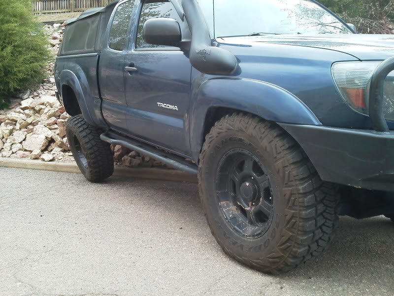

    evolution of my droop
    OME setup all around on 33s
    OME front and fox 10" rear on 33s
    OME front with camburg, bilstein B110 11" rear with ATO flip and 34s
    :cool:

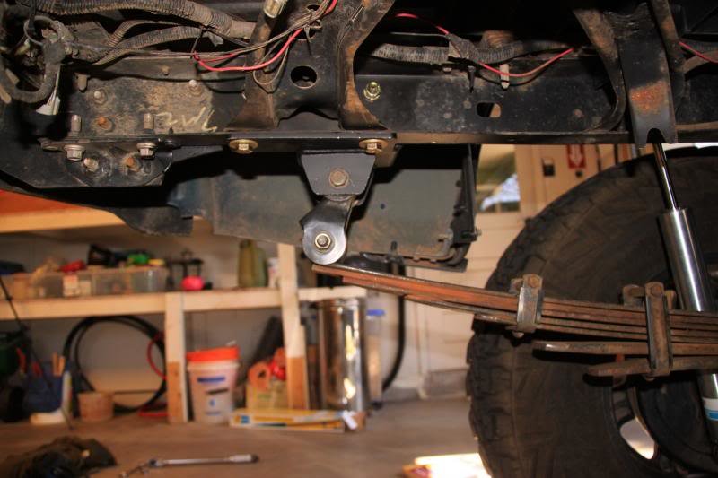

    don't really like the idea of having elongated holes for the mount
    if i were to adjust it, i would cut off the two plates the shackle bolts into and have them welded forward slightly on the mount which would move the upper shackle bolt forward.
    would slightly lower the stance, give more of an "ideal" (ideal is debatable) ride angle and should produce a bit more droop (but i'll have to measure my shock extended to see if i have room left to extend)
  20. May 15, 2013 at 9:54 AM
    #1620
    NYCO
    NYCO [OP] go explore...
    Jul 27, 2010
    #40842
    19,126
    bOb
    Colorado
    Blue Betty - '06 TRD OR
    dents & scratches
    you can see in this pic that the two plates the shackle bolts to are set back on the mount with room in front if i wanted to move this point forward
