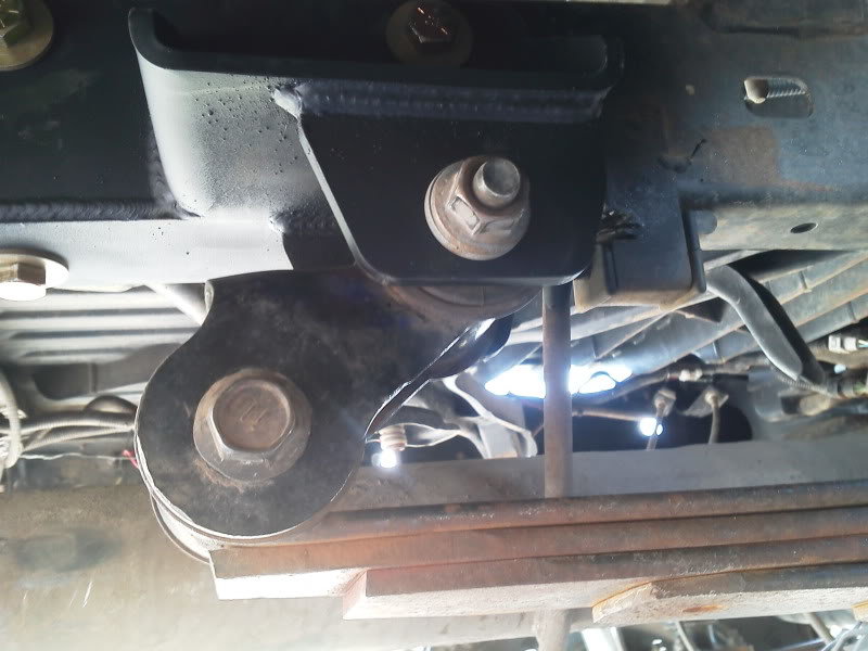

    yes. he also agreed that there was a difference in my angle and where he designed the mounts to be.
    very happy with how he handled things and helped me out.

    i was fine with modifying my setup. i showed him photos and he was not happy with how it turned out and so he sent a new set.
    i cannot say how others will work. i'm not sure your angle on your comment, but it was not his problem to fix, but he worked with me to get the problem fixed.
    his kit has worked fine for many others, but for some reason, my dakars did not cooperate as planned or the mounts were slightly off.

    well when i installed mine and first saw the angles i knew something was off..that's when i asked around and told adam about it.
    he saw the angles and agreed that it was not acceptable
    he said that he's had numerous customers' installs go great and produce acceptable angles. so it was uncommon to have the errors that i have.
    from my experience with this, adam has been helpful in resolving the issue
    and it's not like my truck was not driveable because of this as well. it has been driving fine, and from the pics i posted of it flexing, it does its job. it's just not the ideal angles that are expected with this conversion

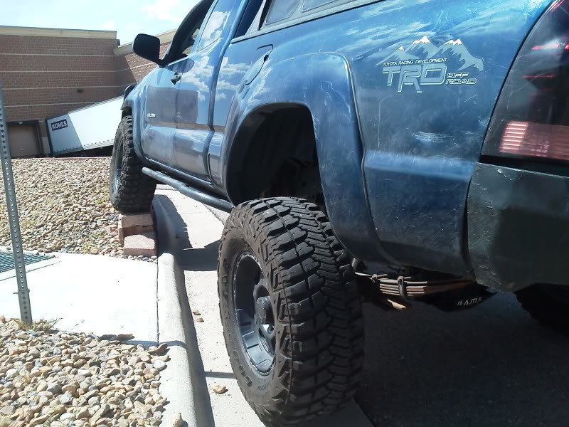

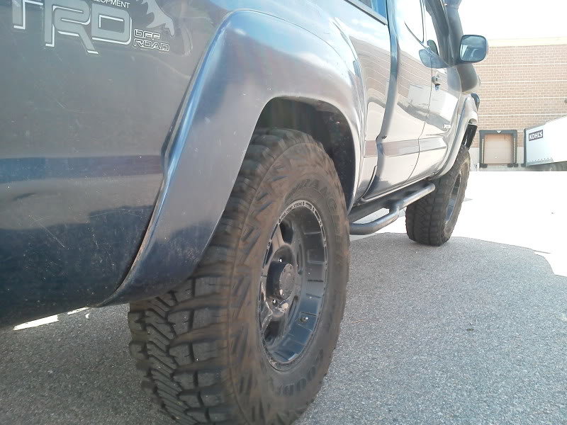

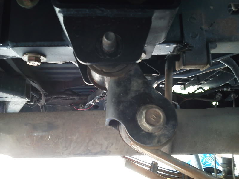

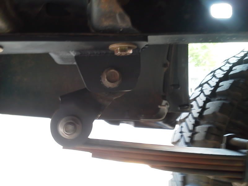

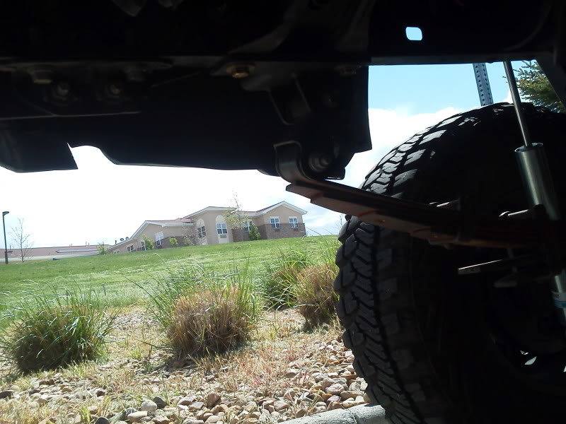

    new hanger is in...
    old droop
    new droop
    all of the shocks are pulled when axle is hanging
    compression (forgot to get a shot of the leaf)
    not fully compressed
    droop (not full)
    not fully drooped
    new ride height
    spot i took the previous shots at had some employees back there, so i found this spot...not the best

    angle looks alot better

    updated #'s
    ground to hub-centered fender
    41 1/2"
    center of hub to flare bottom
    25 1/4

    yup...a lot more like i was expecting
