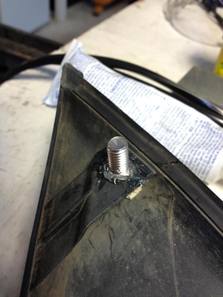

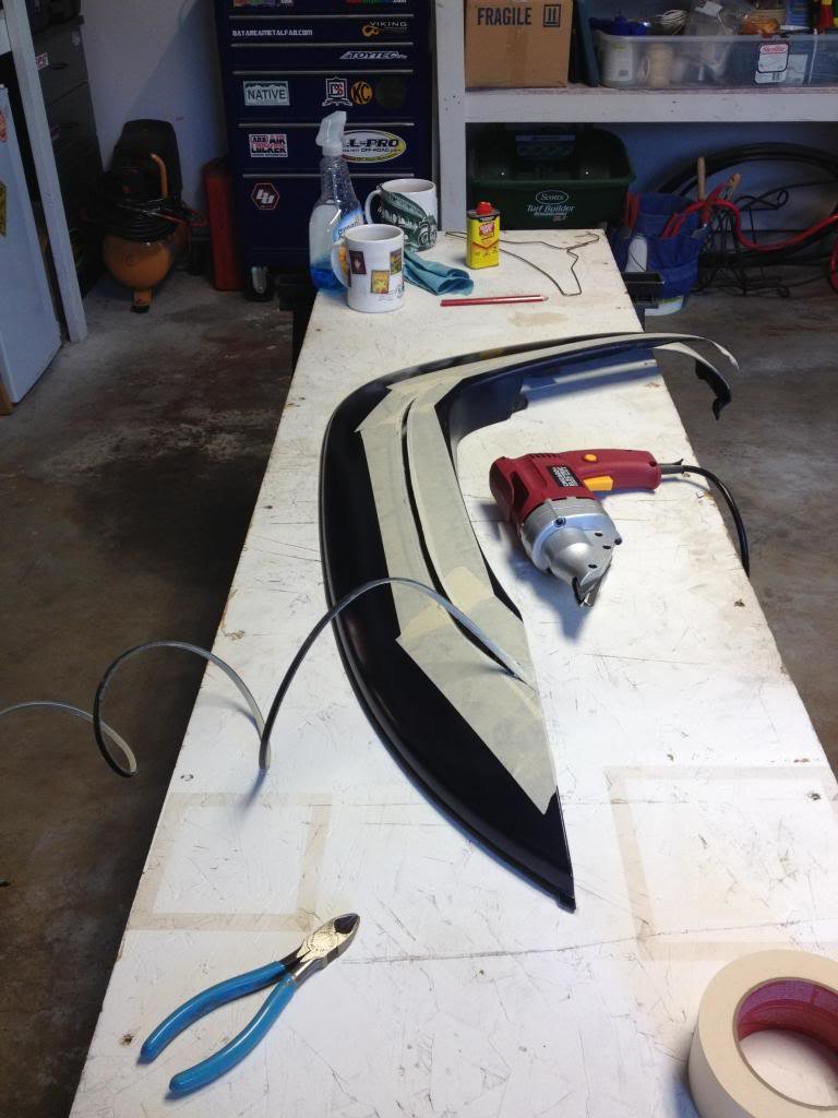

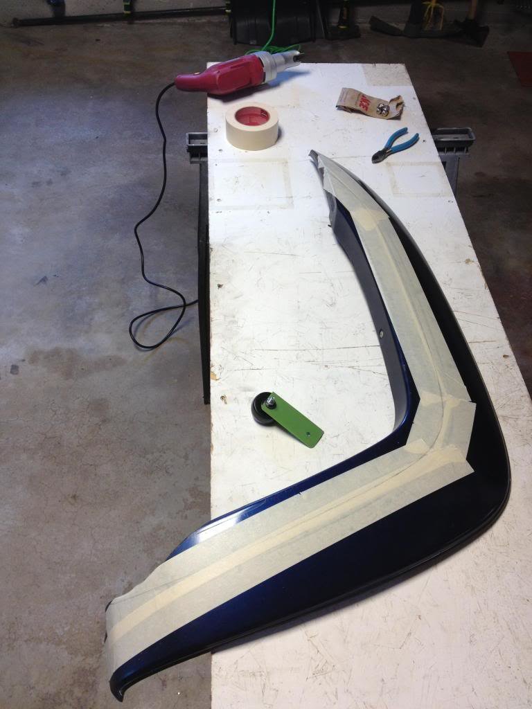

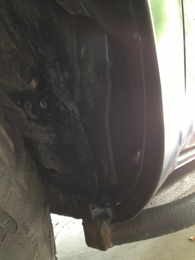

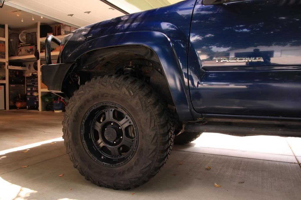

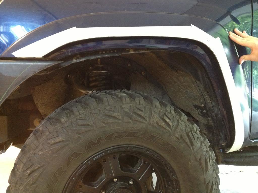

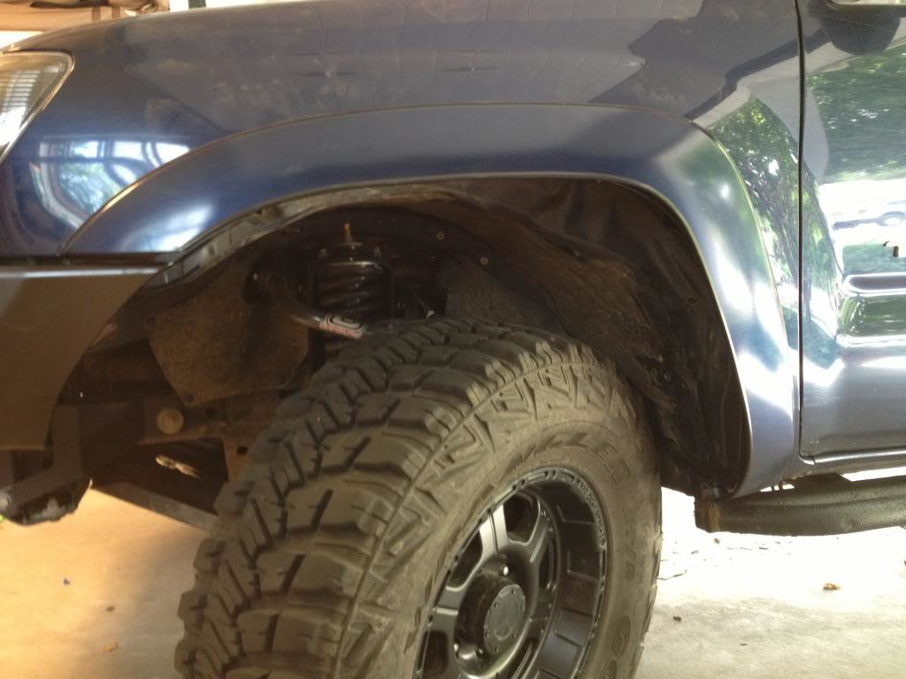

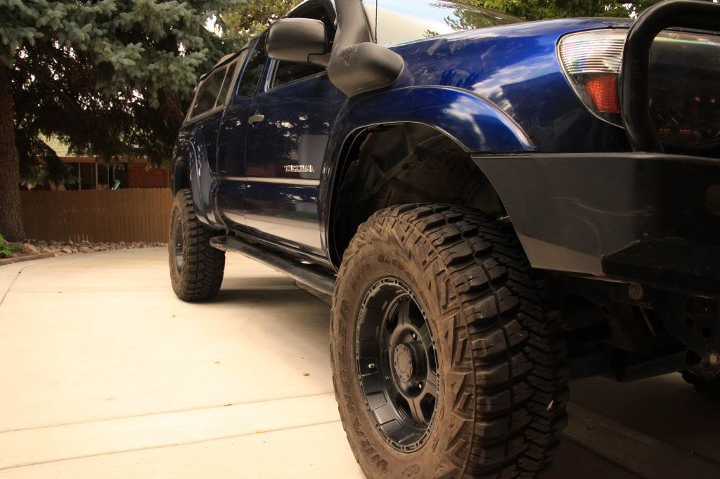

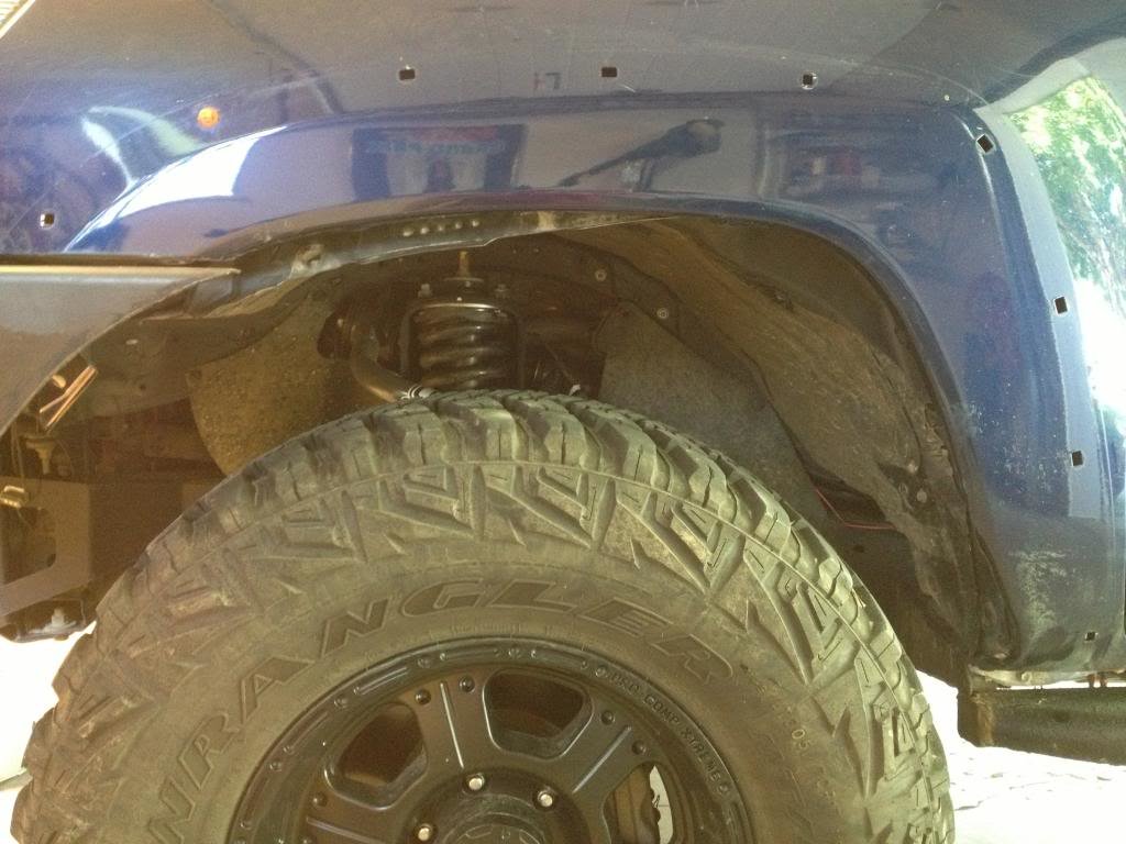

    front fenders are clearanced. gotta thank eric for the hand :cheers:
    took 2" off the flare and fender. had to reshape the ARB as well to match the flare. we ended up continuing the arc of the bumper into the flare until it met up with the 2" cut line for a smoother transition.
    i retained the rear lower screw mount to help secure the rear portion of the flares. front clip i replaced with a 5/8" carriage bolt. this allows the front of the flare to be secured and pulled into the fender better. remaining clips were replaced with ebay clips and a touch of silicone. edge trim used around the edge of the flare and fender were cut. factory liner was also retained for now and held in by the tabs we kept of the fender. the inner mounting points of the fender liner were retained and outer portion of the liner is just held up by the tabs.
    all and all, i am very happy with out they turned out. gotta figure out a good solution for the liners and i still need to finish off the rear fenders to match up with the fronts now.

    flare removed and cleaned fender

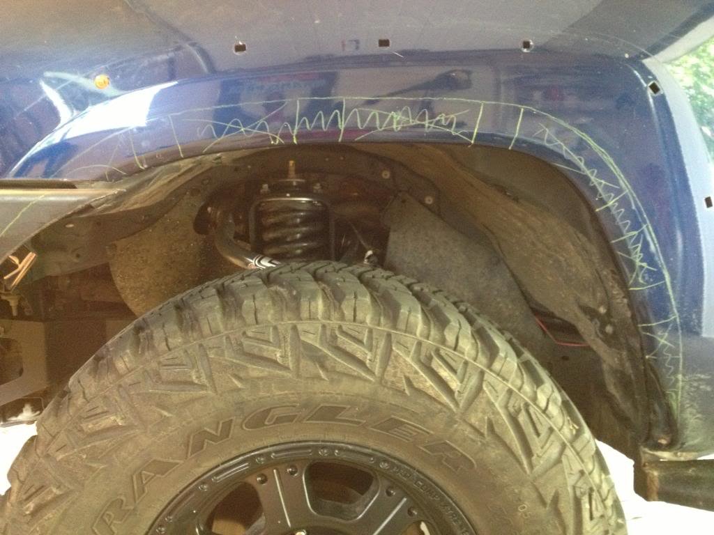

    2" line marked. trusty tool for the day, squeegee with a wheel attached :D
    electric shears made easy work of the flares
    flares held up for analysis. full fenders still behind and uncut bumper.
    game plan for fenders. keep 3 tabs. front mid and rear.

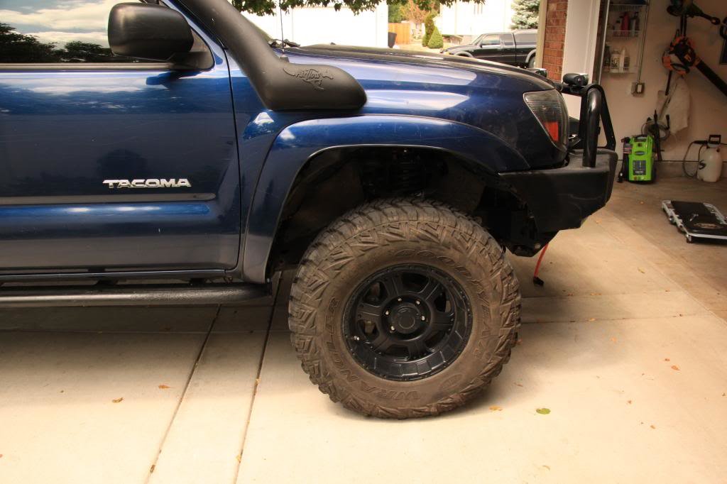

    final product with edge trim installed on all cut edges. bumper cut with matching arc on flare.

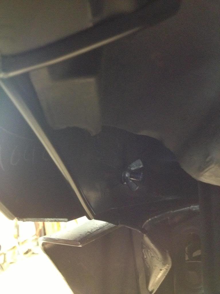

    front mounting solution. 5/8" carriage bolt with some silicone to help fit. the 5/8" fits nicely in the square hole for the clips, but the silicone helps down the line.
    washer, blue loctite and wing nut used to hold the front mount in
    rear screw retained to help secure the flare

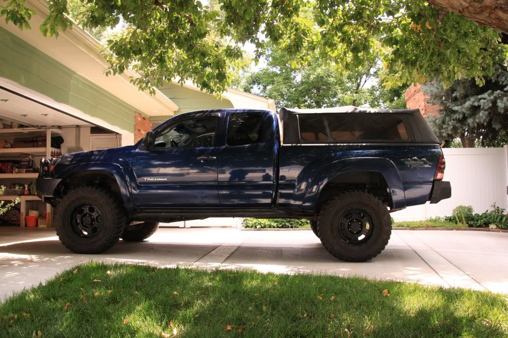

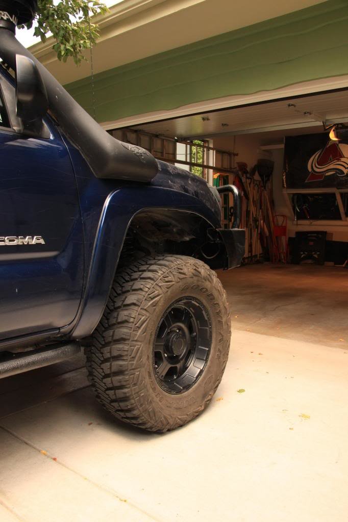

    final product shots

  17. Jul 15, 2013 at 7:10 AM
    #1797
    bulhas
    bulhas the habs fan
    Dec 17, 2010
    #47857
    4,940
    Joe
    Edmonton, Alberta
    1997 Rexus
    LS Swap 500 hp......
    looks good Bob
  18. Jul 15, 2013 at 7:56 AM
    #1798
    la0d0g
    Jan 25, 2011
    #49903
    19,906
    running for the hills
    For crawling not hauling
    Nice job! I like the carriage bolt idea for the front.
