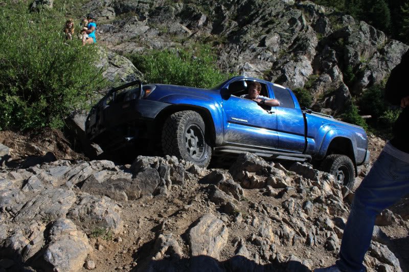

    yea it is...last thing i wanted to deal with...
    was looking forward to revisiting this trail next weekend :(
    i now have a flat belly and bigger tires :D
    got caught up on the all pro tcase skid at this spot...broke the rock while winching past the hang up...the cross over was chopped immediately following that trip and i've been dying to go back ever since...
