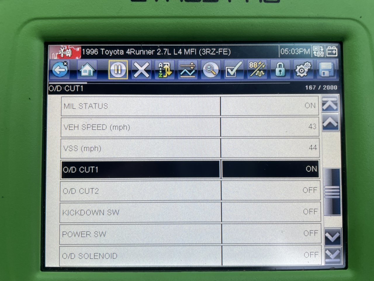

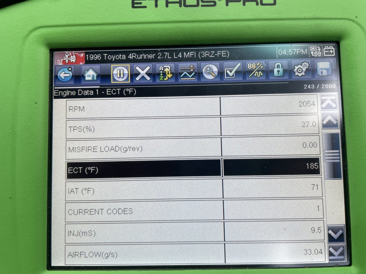

    Driving to work this morning, I noticed the vehicle would not shift into overdrive for the entire 30 minute drive. Same thing this afternoon driving home. I hooked up the scanner and noticed "O/D CUT1" is ON in the computer logic. Does anyone know what the criteria for this switch is? If I could figure out what the computer looks for when deciding to turn O/D CUT1 on or off, I could troubleshoot what's going on.
    Some other related notes:
    • The only DTC present is for O2 B1S2 (after the catalytic converter). This code has been present for years with no issues.
    • TPS % signal is active and accurate
    • Engine coolant temp signal is active and accurate
    • Both VEH SPEED and VSS signals are active and accurate
    • O/D CUT2 toggles on and off with the "O/D OFF" button on the side of the shift lever
    • Kickdown switch is accurate
    • TCC (Lockup solenoid) is functioning. It will lock the torque converter in 3rd.
    Any help would be appreciated. Thanks.
    Below are photos of the scanner with some data screens:

    The computer wont allow upshifting if certain temps are not met, there should be two temp sensors on the water manifold, one is for gage indicating the other is for ECU monitoring, if temp is not high enough it wont allow upshifting, suspect ecu temp sensor.
