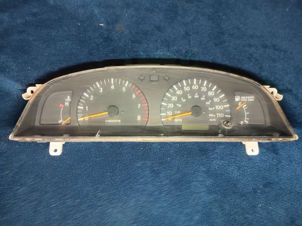

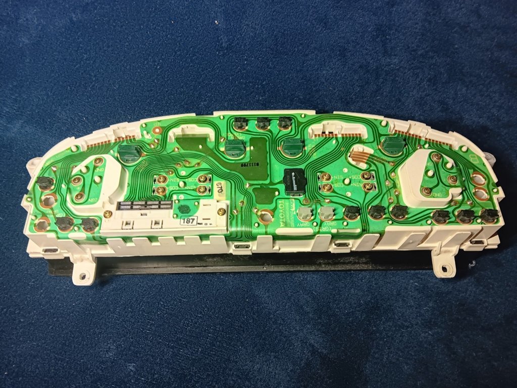

    Anyone got the Light Chart for the 98 Tacoma 4x4 with tack and no D, R , L 2 etc on it? Looking for which bulb is what form behind the dash. My O/D off bulb is out. THX
    Pretty sure this is mine below. Can't remember where it was but I would like to check em all an a legend for which is what would help.

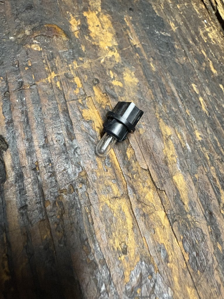

    as far as bulb size

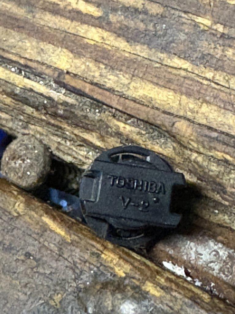

    The black ones look like this
    Says Toshiba V2

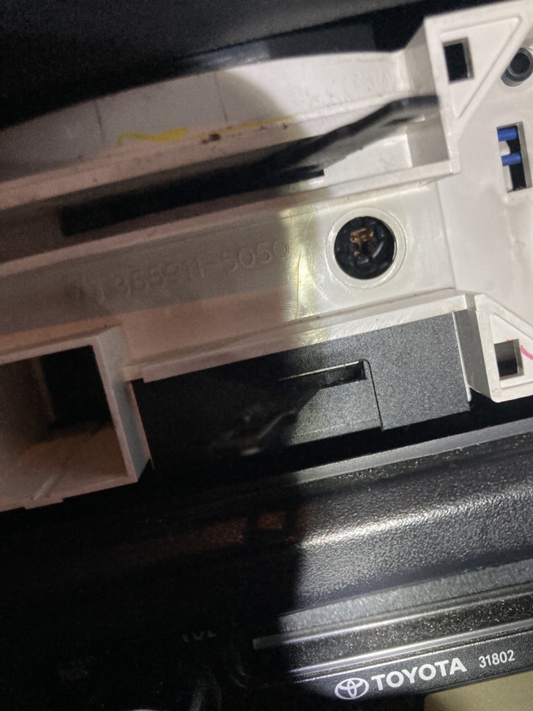

    Bulb thing went great.Worst part was one of the heater bulbs socket pushed inside the assembly. Anyone know how the heck I can get that socket outward? I can't even hold it to push a bulb into it. I was able to grab the very front just to get a bulb into it. But ripped the green condom thing on the light while doing it and now I want to replace that. Also thought about drilling a small
    hole beside it into the white plastic to stick something through to hold it just while I push a bulb into it, but I do not know what is behind it. Any ideas? to get that heater assembly out likely a lot of work.
