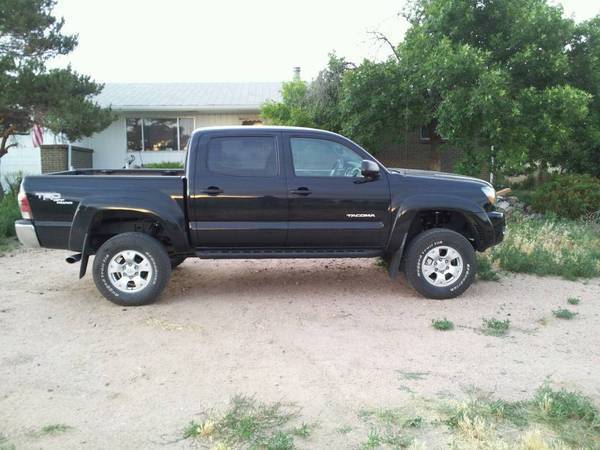

    I had my Old Man Emu 3"suspensipn lift installed today. I am fortunate to live close to Toytec in Northglenn Colorado. I spent some time with them going over my expectations and potential needs and they gave me three choices, read price range. With David's help I decided on the OME suspension lift kit. I went with the 885 coils, top plate spacers and the 4X4 front Diff drop kit. For the rear it comes with the Toytec add-a-leaf and OME shocks. Toytec has the rear shocks on back order so we went with Bilstein 5100 shocks rather than wait for OME. We also went with the Light Racing Upper Control Arms so we can get full adjustment with the wheel alignment. I like the ride so far, the stock ride actually felt kind of soft, this set up has taken out some of the lean in mild turns.[​IMG]

    pics or it didn't happen :)

    ummm yeah
    was just about to say......
    but there are some.
    Nice OP.

    Josh thanks for finding the picture, I don't under stand what went wrong when i tried to include it to the post . I'm not sure why it went so wide either. Computers aren't my strong point. I did get to take the truck on some washboard roads during a rain storm today and where it used to want to crab sideways it now tracks straight.

    The toytec item number is OME-TAK-885TP...Complete OME suspension. When you order the kit from the web site it takes you through the options, and it says you need to order the top plate spacers to get 3" of lift. They also give you a choice of front coils to match your truck and front bumper. It actually gave me 3" of lift and sits level. The ride is stiffer but not uncomfortable, reducing body lean annd a feeling of better control.
