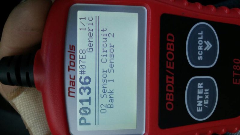

    Came back from Reno this past weekend. I was in the snow. And my truck began to sound weird. As if I have a vacuum leak someplace. Or as if my air filter was not connected to my intake.
    It finally threw a Check engine light.
    And this is the code it threw.
    I read up on it and it should be driver side post cat.
    Is this correct?
    2006 tacoma sport

    Don't deem sensor bad because you got a code for it. Look at the sensor and connections visually and then post your results.
  4. Jan 17, 2016 at 2:12 PM
    Justintheegreat
    Justintheegreat [OP] Well-Known Member
    Feb 20, 2015
    #149152
    553
    Northern CA
    06 DCSB Sport
    I looked at them. There a little muddy. I don't see anything broken or foreign. Everything is plugged in.

    Yea everything was tight I just went out and bought one. Figured I had the money and maybe I was stressing over something that's nothing. But we'll see if the code comes back. Cleared it and reolcade bank 1 sensor 2
    But I can still hear the vacuum leak sound.

    Exhaust leak maybe...

    If it was indeed an exhaust leak where and how could I find ii

    The most common point is at the attachment flanges. where there is a doughnut gasket.
    Crank it up and crawl under and inspect each flange for leaks.
