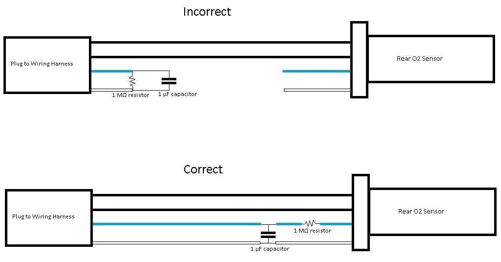

    How many sensor bypasses do I need on my 2001 V6 Tacoma Prerunner?

    I remember just needing a single non-fouler for each CAT I deleted. This was of course on non-Tacoma vehicles, but same difference.

    One downstream

    This never works well!
