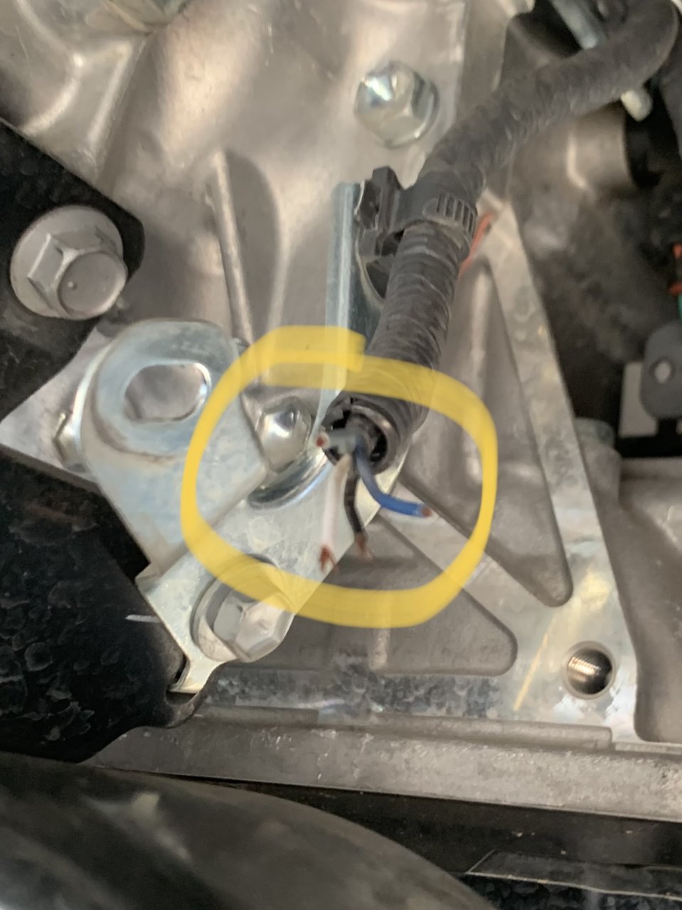

    Thanks for the quick reply! Unfortunately, those colors don’t match what I’m seeing. My truck’s wires are black, gray, white and blue. Picture attached (sorry it’s not better, hard to get a good photo under there).

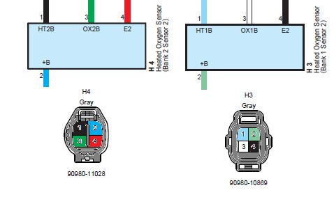

    Edited the info...

    That did it, thanks a bunch!

    I have 500 of 10869, it’s the DRL connector used in the Oem led headlight conversion. I don’t have any 11028 though. And I’m not certain which is correct for OP, that’s where a photo of the other side might help?

    Be aware that you have a power and ground wire there for the hego heater. The other 2 are signal and ground for the sensor. Some times the hego heater power fuse can blow from a short to ground or that 12V can get back to the pcm and damage it. Be sure of your wire placement. (I am speaking from Ford expertise and suspect Toyota strategy to be similar)
