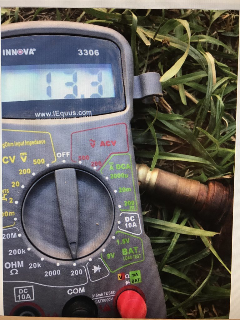

    This is a '02 Tacoma 3.4l...
    Test the upstream & downstream
    Bad upstream...
    Good downstream...
    FYI...I replaced my catalytic converter and upstream
    Good luck!
