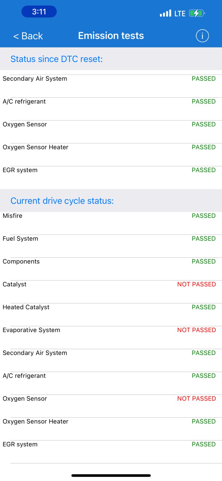

    I noticed last week that my truck started to knock during more so than just lifters cycling as it’s always done. I could hear it sounded as it was coming directly underneath my driver seat once the began to try and diagnose. My truck now has 168k miles on it and I’ve owned it since new. Never changed o2 sensors in it or ever for that matter but I’ve changed spark plugs and done all the regular maintenance on my truck since I’ve owned it. When using my scan tool I’m getting this but no code is being triggered in the dash board. Not for sure but i believe the bad sensor is the “before CAT” sensor pretty much located directly underneath driver seat… please correct me on that bc i may have bought the wrong replacement. Ordered the “downstream right” NTK…
    Also I’ve cleaned mass air flow sensor with Crc MAF cleanser and I’ve followed the guide on cleansing the throttle body and changed my air filter within the last couple weeks.. just as an fyi for diagnosing the issue. I’ve also checked pulleys for being loose. It doesn’t do this always. Just intermittently
    also does anybody know what the evaporator failed may be? Would this have to do with O2 or CAT converter as well?

    While I don’t know, before you go replacing parts, I would warn you to fully understand the tests being performed, as some are performed only under certain conditions. “Not passed” may not mean “failed”. But a tech here will probably be able to better help.
    Also, I doubt an O2 sensor is knocking,,, the exhaust system maybe.

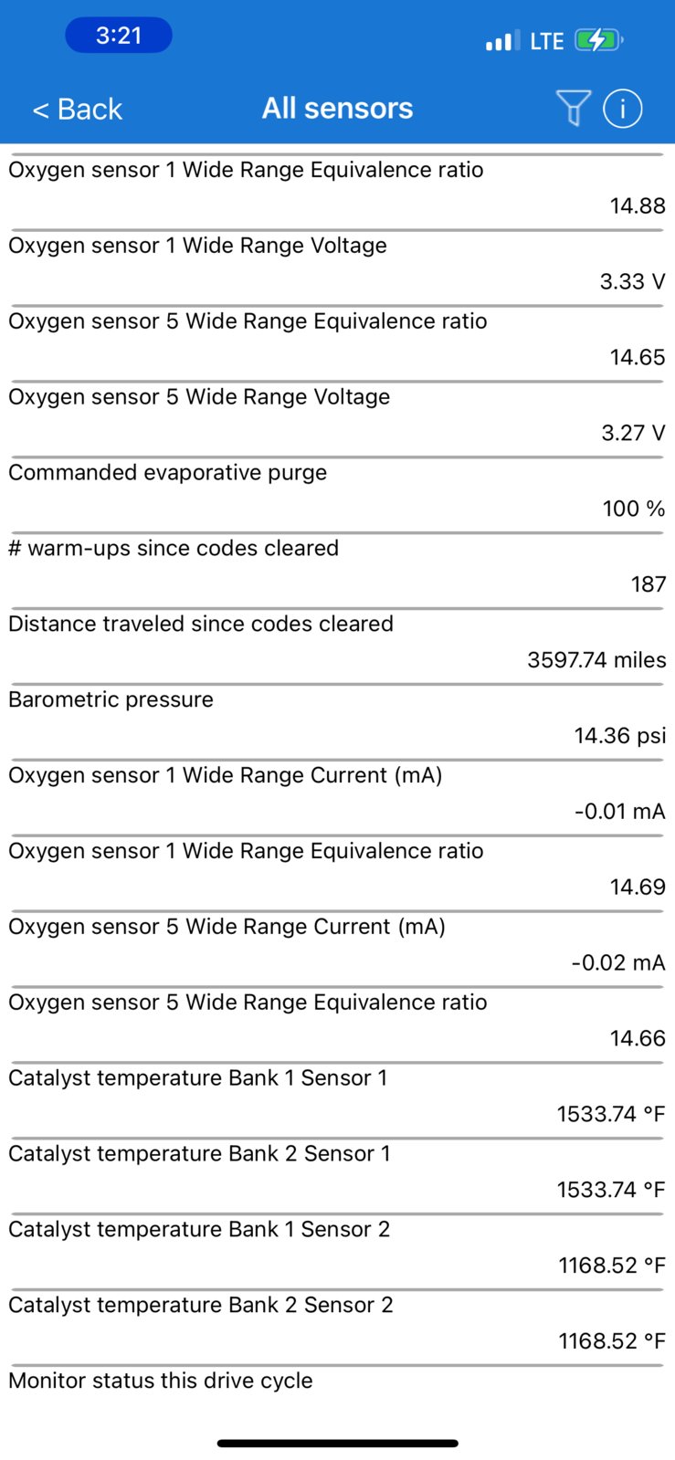

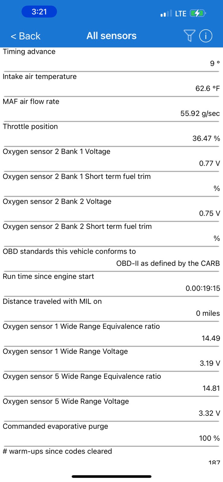

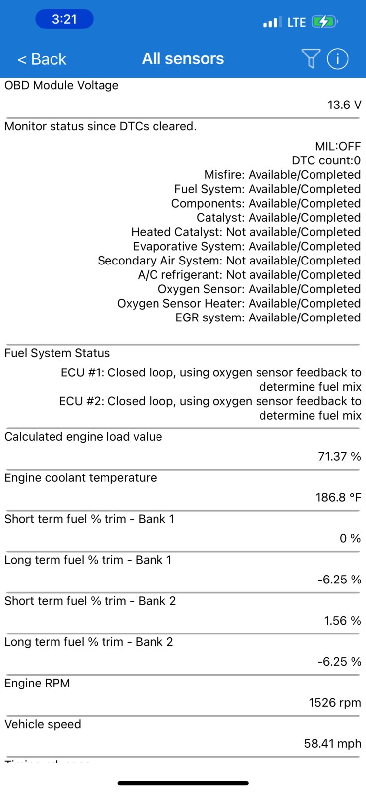

    IMG_8125.pngIMG_8129.png Also here is what I’m getting at 60mph highway driving currently IMG_8127.png

    Thanks for the response and It may not be knocking but I can tell you it’s coming from the exact area where the o2 sensor is before the catalytic converter… hopefully it’s not the CAT… I’ve heard of o2 sensors making a knocking sound but maybe I heard bad info?? What gets me is it runs as good as ever bessides idling..

    It’s a VEEPEAK ob2 dongle I have attached at all times it’s very helpful just wish I understood the info a little more thoroughly

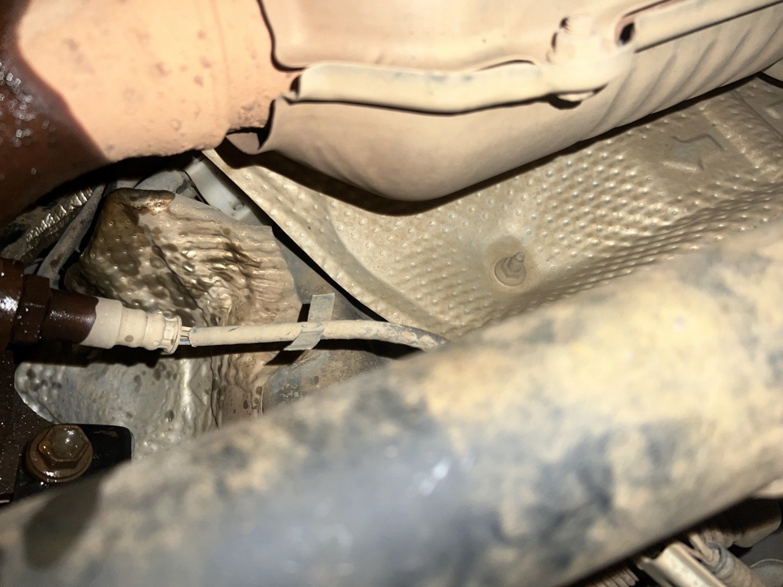

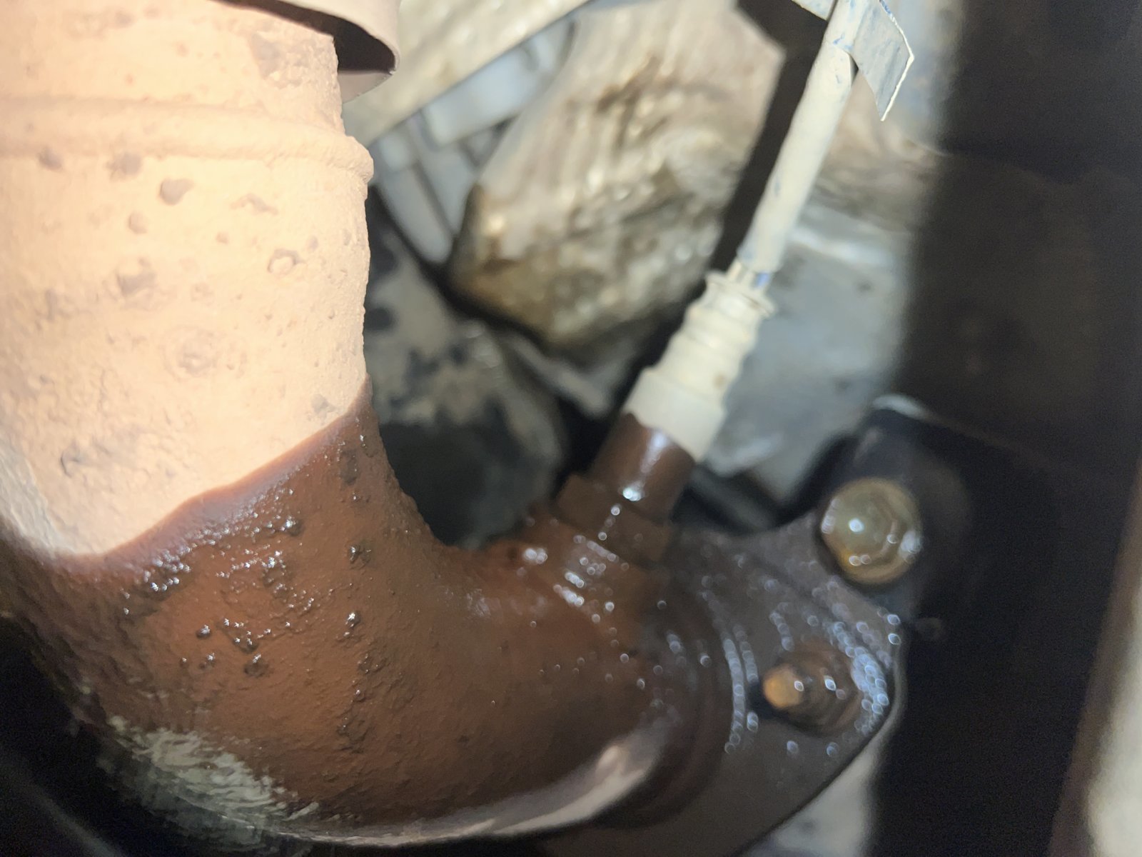

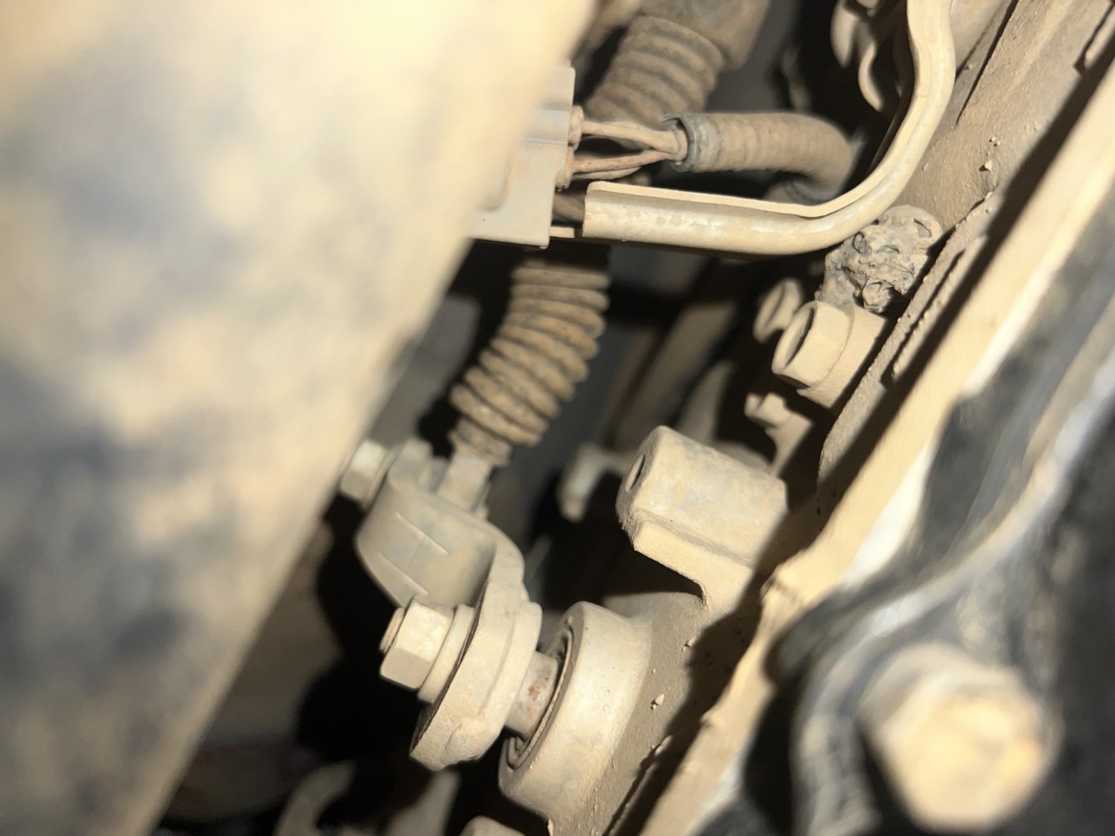

    Here are some pics of where the knock is coming from maybe this will help. It looks like it connects to a connection on the atf system.. if you can identify it for me I’d appreciate it IMG_8137.jpg IMG_8136.jpg IMG_8138.jpg

    Could be the inside of the cat coming apart. I mean you do have lot of miles man or possibly a hear shield broken and banging around

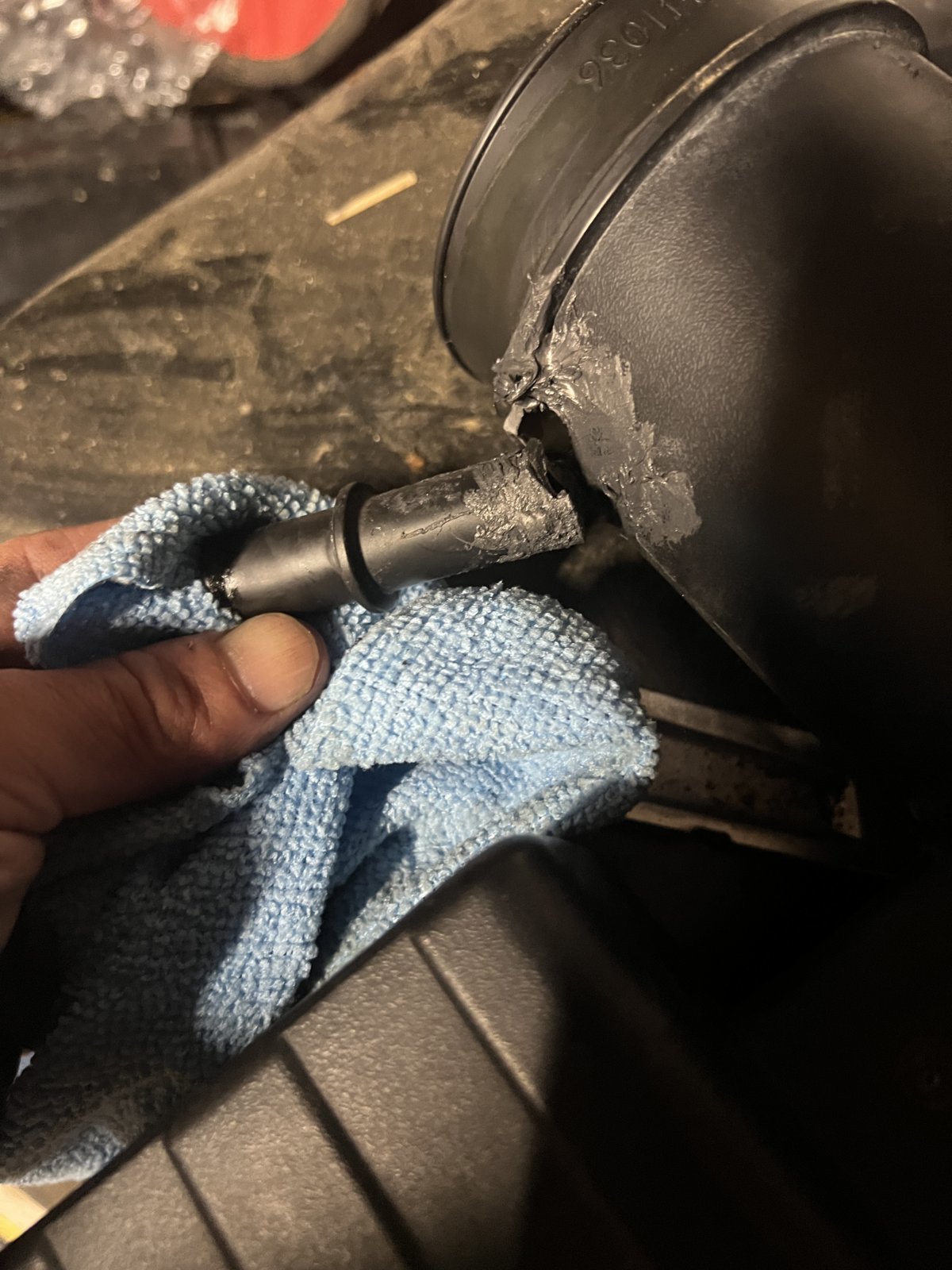

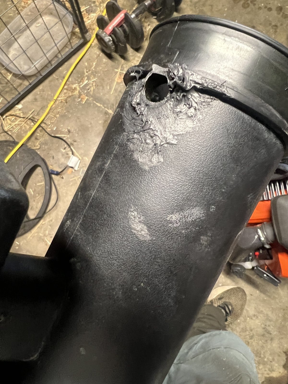

    Pretty positive I’ve found the culprit and hopefully it’s not been like this long. Seems to be running great besides that intermittent knock. I just changed the oil after discovering this about an hour ago and use sea foam regularly maybe it’s cleared and h20 that may got in…
    It wasn’t broken off completely when I found it but it was definitely cracked and about ready to break off though. I pulled the hose and discovered it. I started to JB WELD it for temp fix then Luckily I remembered that I kept my original intake and installed it while I wait on HPS to have their silicone back in stock bc I’m not buying another plastic one for this reason.. DAMNIT! anyway I wasted time and bought o2 sensors I doubt I even need

    That’s why I’ll only run stock oem intake or TRD intake

    This was actually TRD intake that cracked. Been on my truck for 80k now

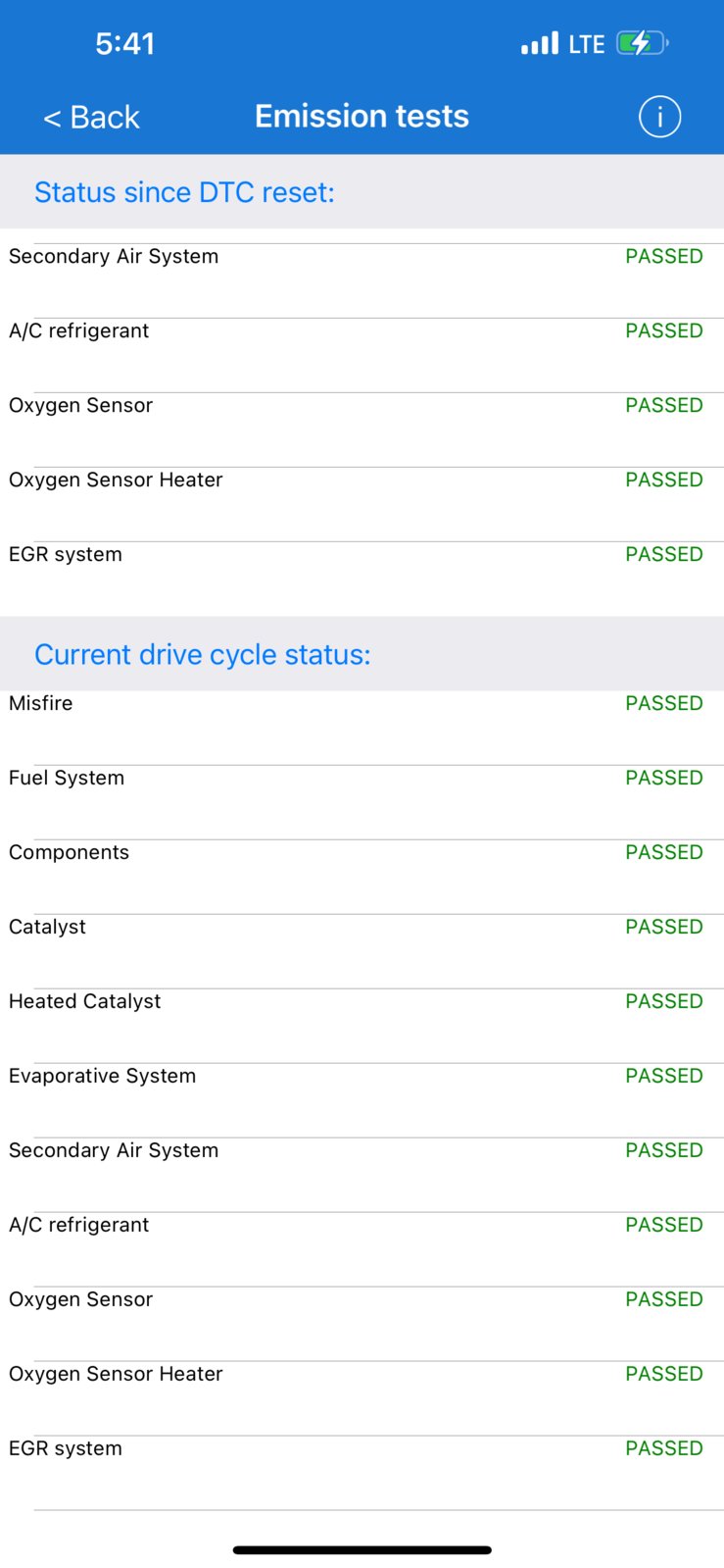

    IMG_8262.pngUpdate installed air ratio sensors today and o2 sensors and now everything seems to be “passing” so maybe they were needed and due. Didn’t hurt anyway to freshen them but can’t really feel much of a difference in driving it yet
