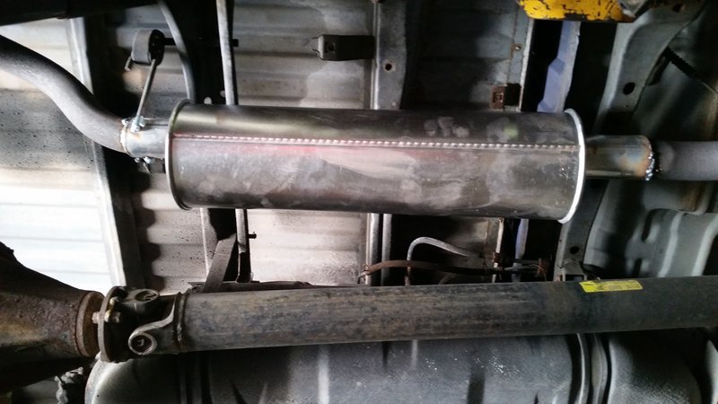

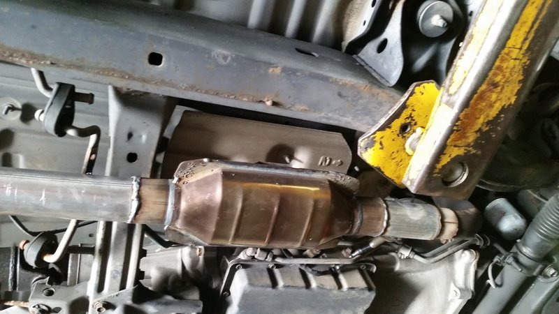

    Problem solved! New welded O2 sensor mount, new Flowmaster catalytic, and new muffler. Come to find out the previous owner bored out the old cat. Cleared code and has not come back. Truck drives great now. No more hesitation. Old man is happy. Thanks to all that helped me out with this.
