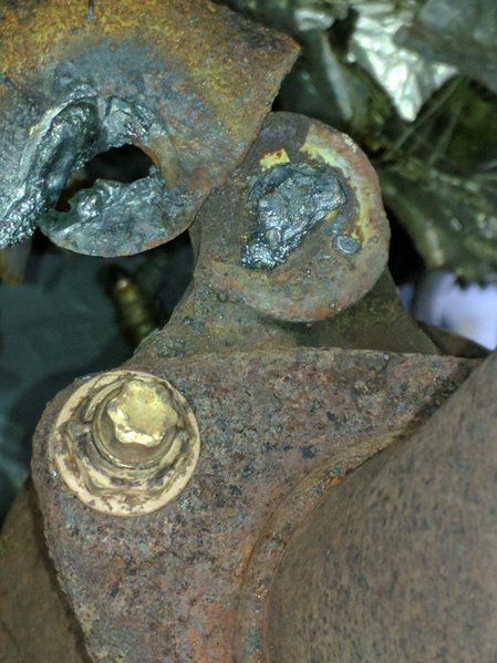

    The saga continues... Looks like I see soon soot under the bolt for the support bracket that he used his handy dandy acetylene torch to burn the bolts off rather than remove the bracket from the transmission housing. Time to call around to see if I can find a gasket.

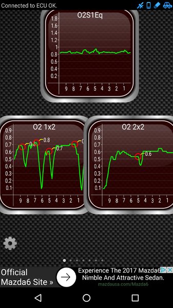

    O2 sensor readings are supposed to swing high/low.

    Damn that is a lot of rust! The heavy duty gaskets from URD are really good!

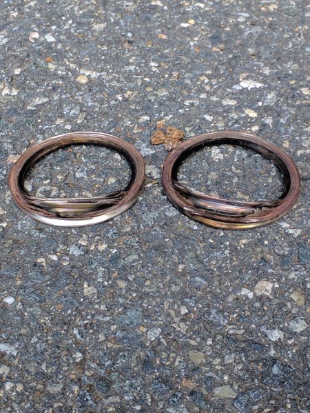

    Quick easy and for the most part, painless. It looks like someone couldn't be bothered resetting the gaskets properlyIMG_20161016_120509.jpg

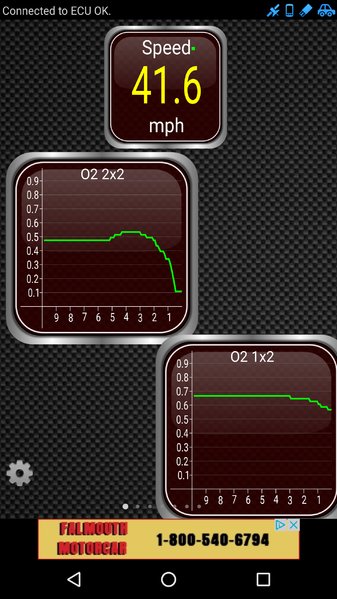

    I'm am indeed a happy camper. I reset the light and put about 10 miles on it. Id think the ecu would do is efficiency(lean,rich) test in that time. Letting it sit now for 10 minutes or so and then gonna do another drive cycle.
