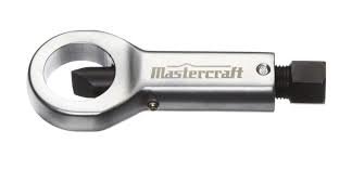

    If it works this might be better than grinding.. And note this was in reference to the note about how to remove a nut if you have one. Obviously not about the case where there there is no nut.
    :confused:
    Note, i have never used one and dont own one but what about using one of the nut splitters to get that nut off??
