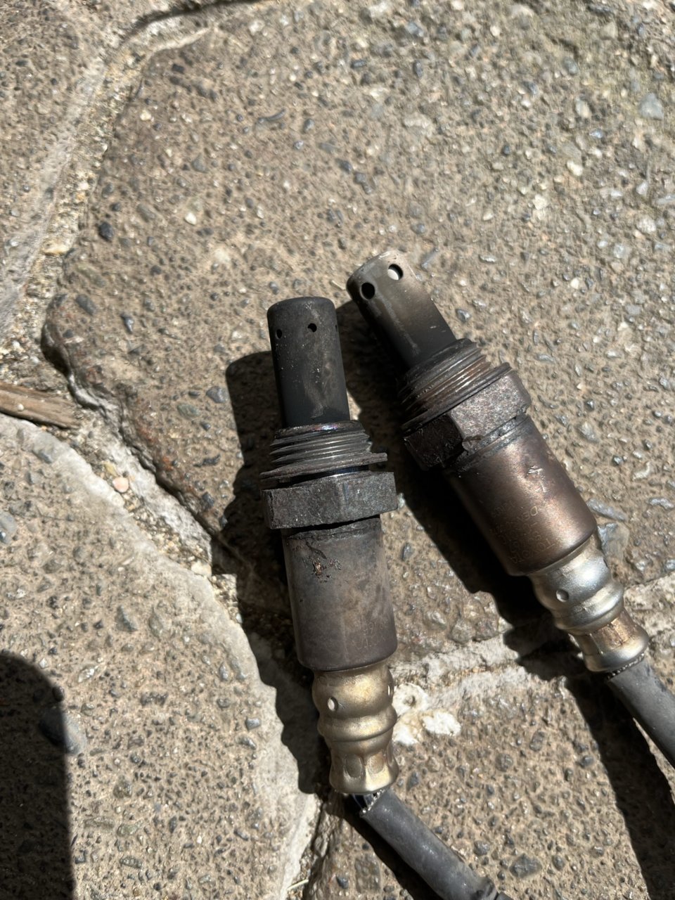

    Just finished what was supposed to be approximately a one hour job into a three hour one because of the stuck on plugs from the sensors. Anyhow, finally got off both the upstream and downstream sensors and perhaps it's placebo but the truck seems peppier and more responsive (probably placebo LOL).
    Here are what the two sensors looked like and a tip for removal is definitely use a blow torch or penetrating oil to loosen, a 7/8" wrench and a hammer.
