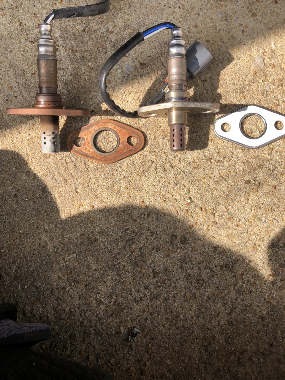

    I had a lean code and noticed I still had the factory o2 sensors so I ordered a new upstream from rockauto. Turns out it was just a cracked vacuum hose. So instead of returning it I just soaked the nuts in Pb blaster and installed the new one. Pretty easy 30 min job for me. Both are denso sensors. The one that came out was a bit fatter on the end and had Toyota denso printed on it. It was still functioning fine at 219k miles amazingly.

    I had a p0171 and it was the rubber hose that connects on top of the upper intake manifold. It runs to one of the sensors coming off of the charcoal canister. The backside facing the firewall was split about a 1/4inch max but it was enough to suck air and toss a lean code. Did you happen to check to make sure the electrical harness was clean when you plugged in the new sensor? Could be a wire issue, exhaust leak, vacuum leak, faulty sensor too. What brand o2 did you go with?
