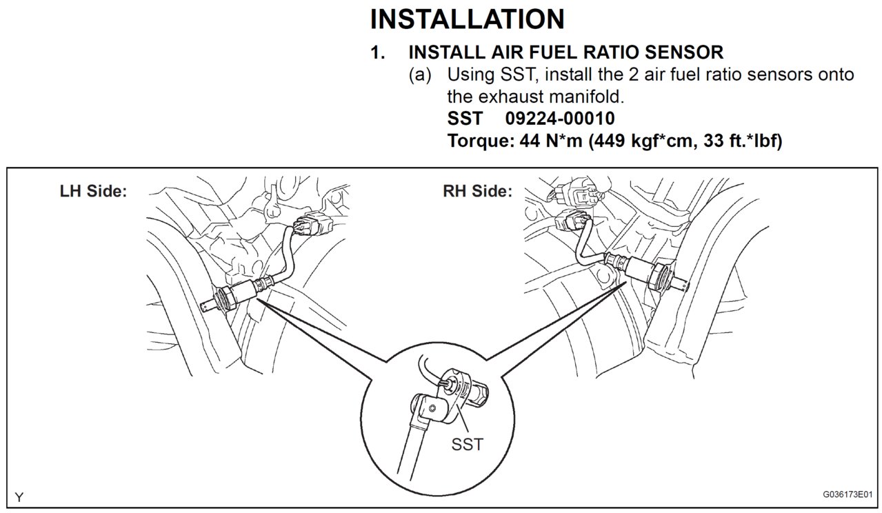

    The FSM actually doesn't call for removing the exhaust -- instead it looks like they specify a specialty tool. If you haven't seen it yet, here's the graphic:
    Looking at the picture, it looks like what you actually need is a crow's foot. But if that doesn't help, my honest advice would be to start dropping the exhaust Y pipe and front driveshaft so you can just remove the manifold. Along the way, keep an eye out for a chance to finally get your wrench on that stupid sensor.

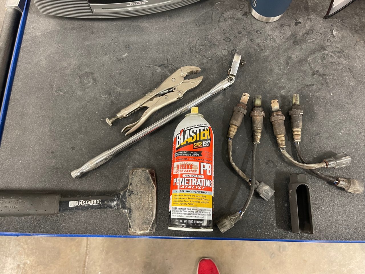

    I just replaced all 4 last week, these will be your friend. Especially the swivel ratchet. It was easiest to remove all 4 from under the truck.
    Crom, Torspd and Oldewing1800[OP] like this.

    Now that I got, both 3/8 and 1/2, I like the deep socket, where did you get that.
    Oh, and I do have PB Blaster, works great, stinks but works great...

    I bought the swivel from Matco but I'm sure you could buy something similar from Lowes. I bought the deep socket from Rock Auto for $5. I wish I had gotten the small socket though. This socket wants to spread apart when the O2 is tight.

    Knipex parallel pliers, are also very handy in these situations.
