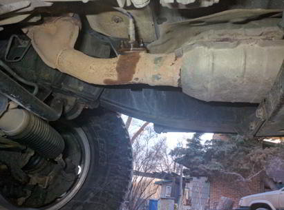

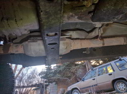

    I have a 1999 Tacoma (3.4 v6, Manual 4x4 SR5) with the check engine light on, the previous owner had a diagnostic tool and told me it was the downstream O2 sensor. I want to replace both sensors, but when I looked up the part for my truck at Denso, the recommended part doesn't match what I'm seeing under the truck. Maybe I've got the names wrong but would appreciate your thoughts on this.
    Thanks!
    Denso says:
    part 234-4154 = Downstream
    part 234-4161 = Upstream

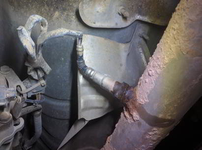

    The sensor in front of the cat. has the metal flange and two bolts, the one toward the back has no flange and looks more like a spark plug.

    Everything after front o2 isnt factory. You cant tell because everythings welded together instead of bolt on flanges.That isnt factory style downstream o2.

    Okay, I had a look on Denso and all the 1st gen sensors have the bolted flange with no threads to screw it in. It looks like it was modified with a 2nd gen catalytic converter or at least the exhaust pipe, because the downstream sensor looks like the ones for a 2005. But I'm guessing that the 2005 sensor isn't going to work right because they only come for a 2.7L and 4.0L.
    I'm thinking I may have to weld some bolts on there to fit the right sensor. Or maybe I need to figure out what kind of catalytic converter it is and match the sensor to that?
    Update:
    The catalytic converter has been cut out and a new one welded in. It doesn't have the o2 sensor, that was cut and welded separately. It is a Walker N/TA/99400 - 17370 - 0613. Still need to get the o2 sensors right...

    It turns out the previous cat. converter was stolen and so this one is new as of 2013. They must have used a generic part for the pipe fitting. On closer look the cat. converter is welded on and the rear o2-sensor is in another small piece that is welded between the cat. and the original muffler. The cable on the rear sensor is obviously much longer than it needs to be, but does look like a plug-in variety rather than a spliced one.
    From what I've read the computer can be picky about non-stock o2 sensors.
