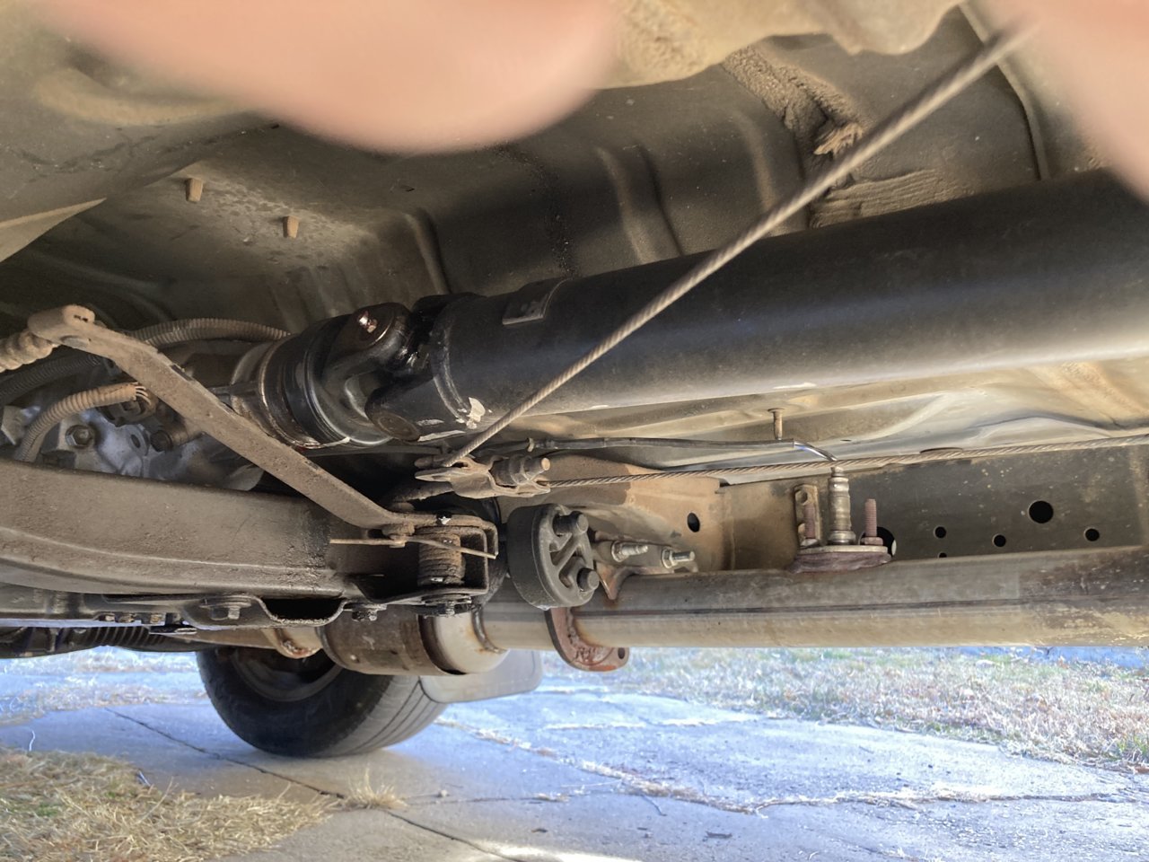

    Hi,
    New member and this is my first post here. Just bought the truck and I am pulling a P1135 code. Got the Denso part to replace the upstream sensor but as I was looking around, it looks like there should be a downstream sensor there as well, that is nowhere to be found. Can't imagine its supposed to be that way.
    How can that be without dropping some other code? Or I am just missing something?
    Thanks for any help/thoughts anyone can offer.

    Yeah, I crawled under and looked and felt around. Didn't know they made such devices but I am at a loss otherwise. Thanks for the input.

    Yes, there is a straight pipe but it didn't appear to be welded, thought it had flanges on it but I could be wrong. I didn't see any lose connector hanging free but maybe it was just tucked up out of the way. I'll have to crawl back under there again and do a deep dive.
    Any idea where such a device may be located? Just curious now.

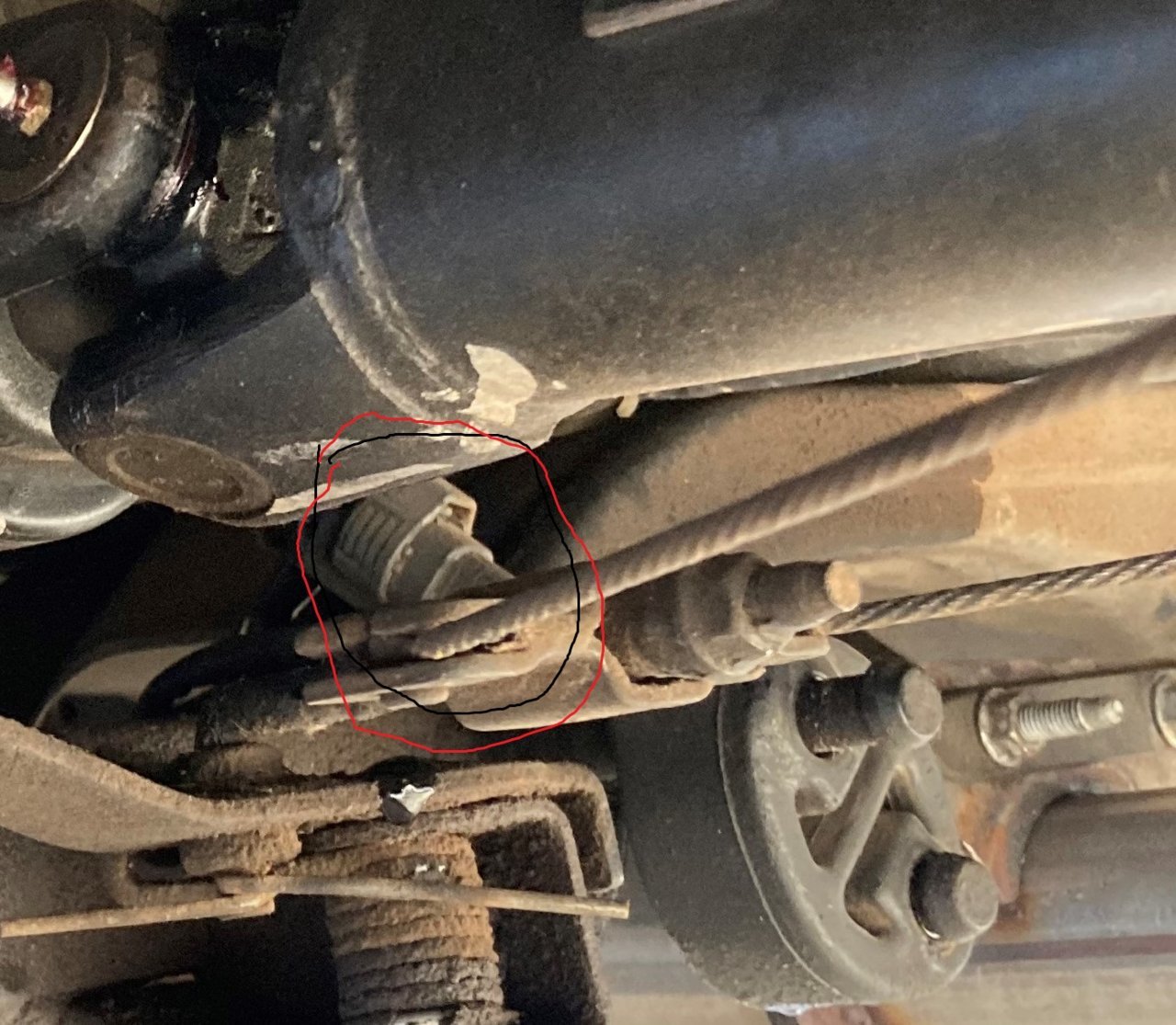

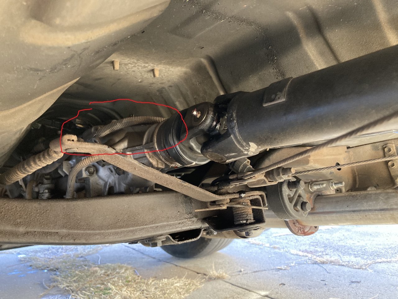

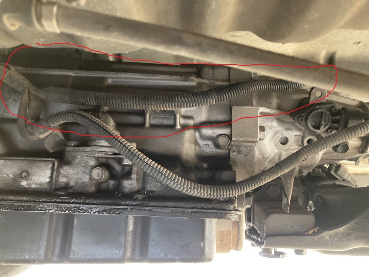

    That back o2 sensor is a pig tail that plugs into the harness right there at the back of tranny...
    HondaGM likes this.
  12. Dec 9, 2022 at 6:52 PM
    O'Silver_Taco
    O'Silver_Taco Well-Known Member
    Aug 26, 2021
    #375390
    4,246
    MD
    98 Dlx Sr5 ext AT Rwd
    3rz to 2Rz bebuilt block and new heads
    Which goes up and over tranny to left side.....
