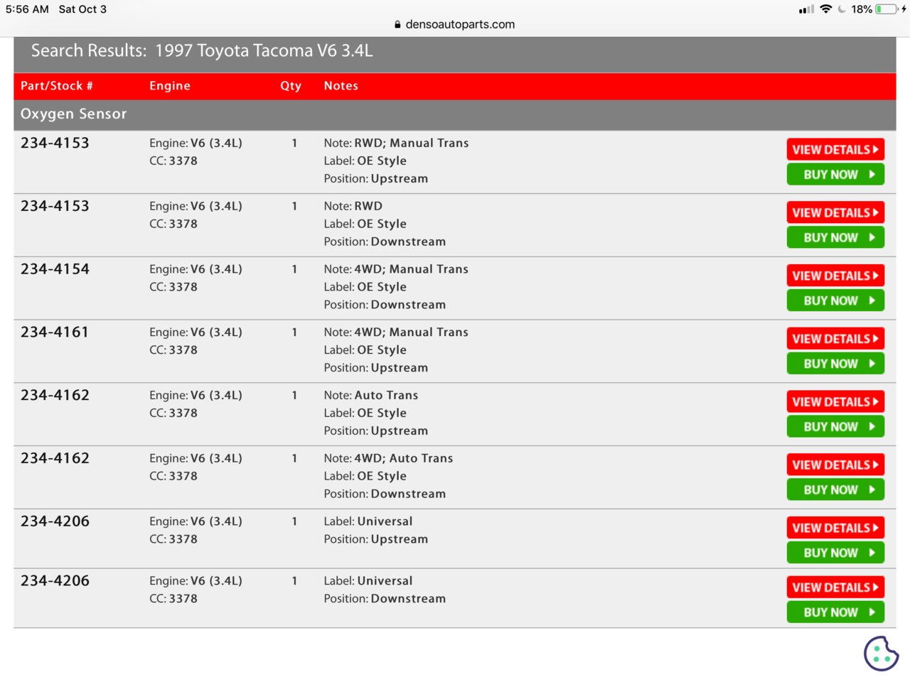

    V6 5sp,RegCab,TVS1320 Supercharger, 56mm pulley, methanol injected Haltech ECU, AC Tvs1320 supercharger,(MUST DO) every 125,000- 150,000 needs rebuild Projector headlights HID 5 speed manual Amsoil for all drive train Smaller 56mm custom pulley, (MUST DO) 2004 DESNO fuel injectors, zero ping ping, 2004 side door mirrors Dick Cepek Rims, Michelin tires LTX, ATM Pathfinders Dynopro ATM ( that last 100,000 miles) Now running Dynopro ATM mud and snow tires KN cold air intake Cat back dual exhaust with ss exhaust tip, Raised exhaust tail pipe to 2" below body line Optima*dry cell battery,red top Alpine sirius radio, 200 watt amp, focal is165 split door pod speakers Focal door speakers Subwoffer behind seat Viper alarm, Electric Locks Dark tinted windows, bucket seats corbeau lg1 Tacoma Rubber floor mats TRD fender extenders, Bilstien shocks, King shocks JBA UCA trailer iv hitch, electric brake control, Drilled slotted brakes, High carbon steel (MUST DO) EBS green stuff 7000 series pads(MUST DO) TRD engine oil cap TRD stick shift, Marlin crawl shift kit. Rear sliding window 2002 4Runner functional hood scoop cut into Tacoma hood, 4Runner dual overhead map light Gentex Auto dim + Compass + Temp, garage,rearview mirror Snow Methonal kit stage 2 Custom 3 core aluminum radiator Linex bed liner Haltech stand alone ECU, Intake supercharger gauge. Stainless steel brake lines, Custom leather wrapped steering wheel, Haltech stand-alone ECU,
    You don’t need the OEM cats to eliminate the 420 unless you bought a cheap cat.
    Sensors don’t need to be replaced unless they are defective.
    The OEM cat is far more superior than any aftermarket cat
    https://densoautoparts.com/find-my-part.aspx

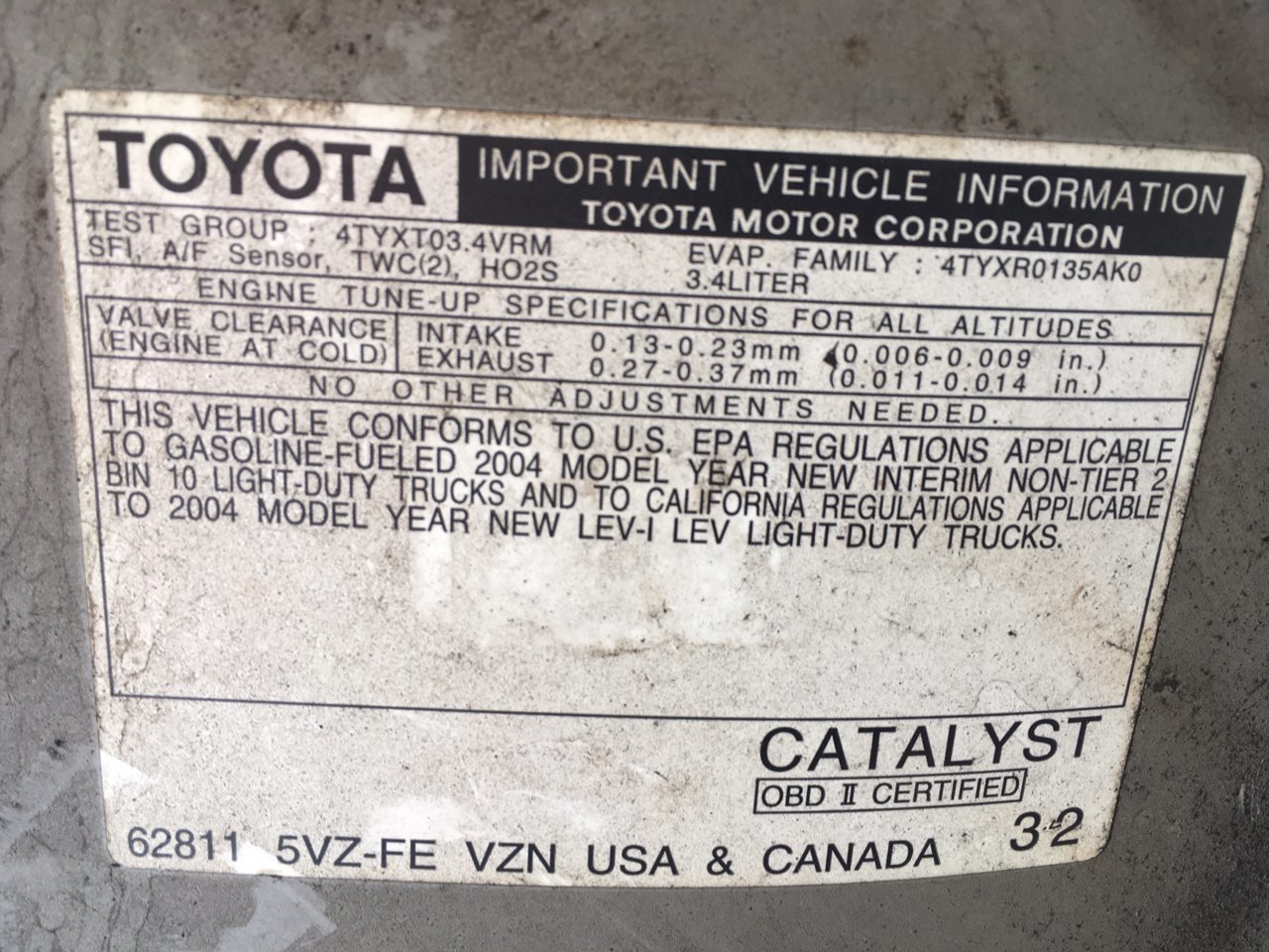

    Thanks for this. I looked over the magna flow site, it's asking if my truck is CA compliant... see attached pic of my tag, i'm assuming it is... looking for confirmation on that. If so, that's kinda weird, b/c my truck was initially sold in Rochester, NY :confused:

    My 2000 Tacoma originally sold in Virginia is California compliant, not all were . My understanding is that from 2001 on, all vehicles were California compliant.
    4Barrel likes this.

    The line that says "...and to California regulations applicable to 2004 model year new LEV-1 LEV light duty trucks"
    That means the truck meets california emissions standards. My sticker looks different, I'll take a picture later.
