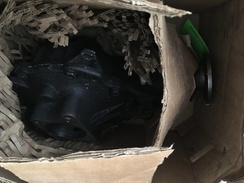

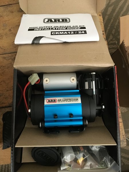

    Well this was just delivered... looks like I've got some work ahead. This weekend going camping/riding dirtbikes then straight off to the sierras with the family so won't be back until roughly a week after that. Then to throw all this stuff in and start the gears break-in.
    Guess I better look up how to break in the fronts cause I have add hubs :notsure:
    Anyways here's the pics..

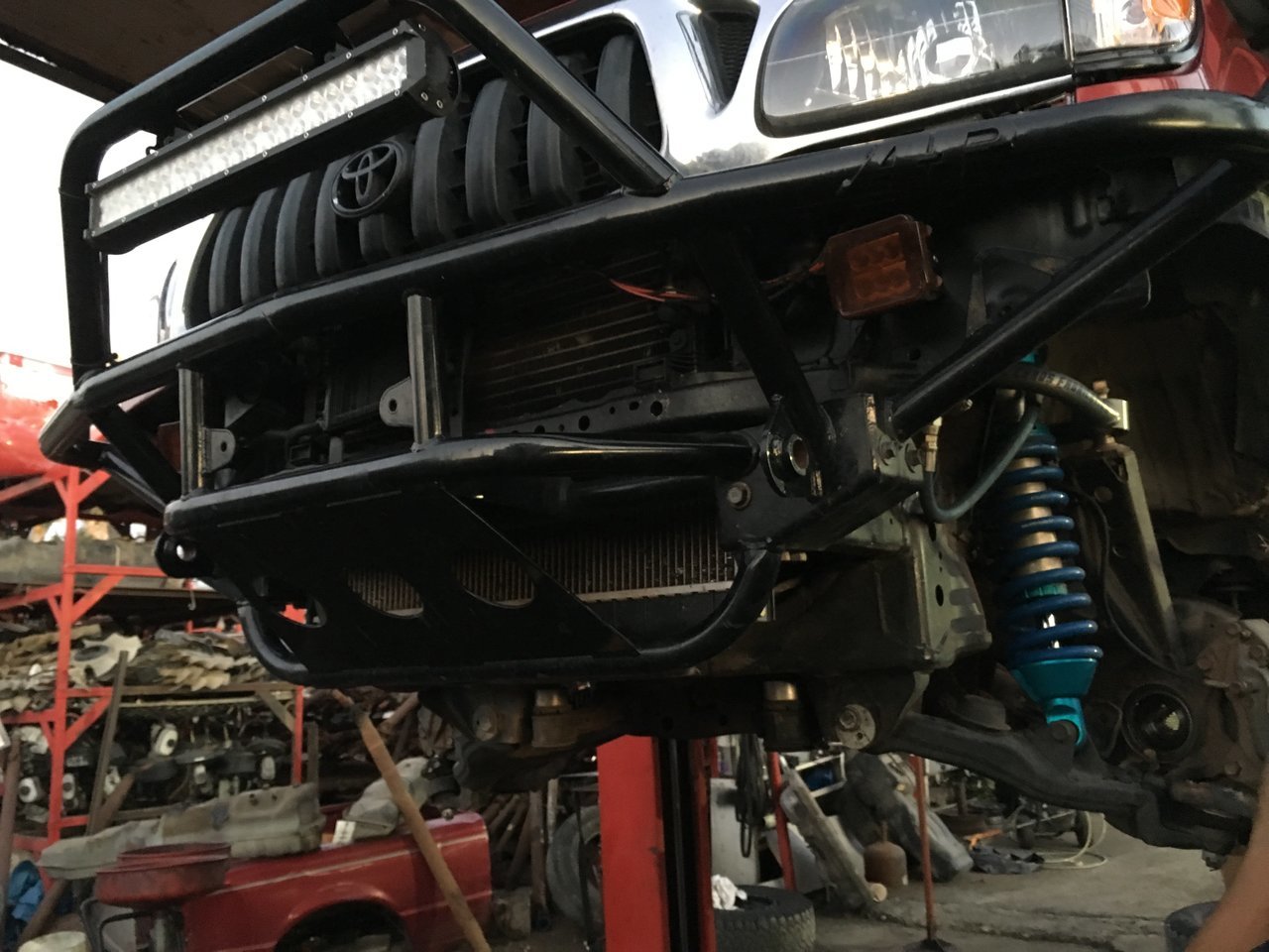

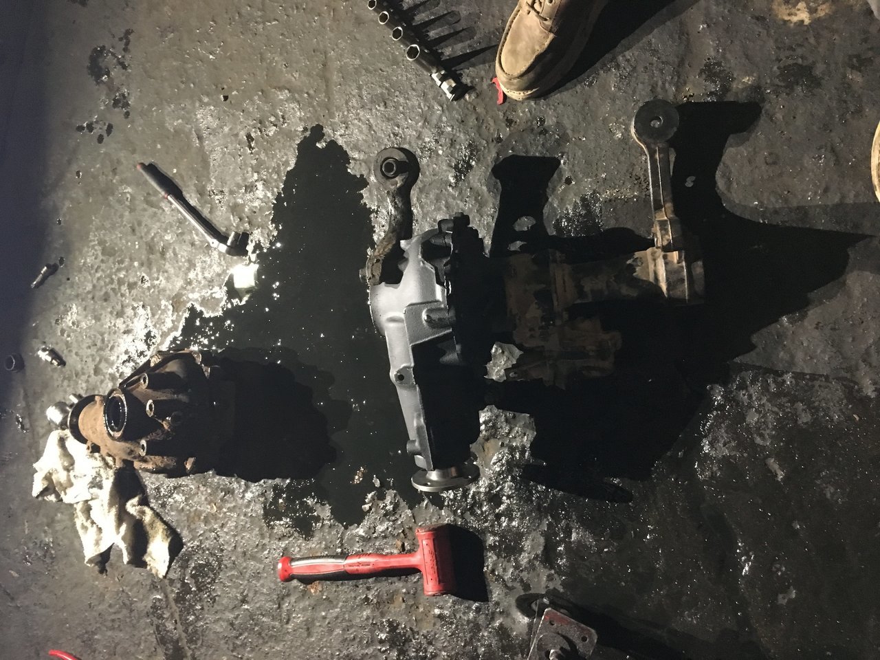

    Finally threw in the third member and arb I got into my rear housing (488 gears). After driving it around and letting the oil warm up a bit I noticed a puddle of oil under the diff. Thought that the seal we put on there failed and I would rip it out at 500 miles later (checking oil level) after the gears break in so I wouldn't waste a bunch of new oil. Turned out that the leak was coming from the actual arb stud that the air line goes into. I capped it with the arb bulkhead kit that supposed to hold the air line and surprisingly no leak!
    Also threw in the front diff. After a long evening of installing the rear and front diff I decided to throw it in 4x4 on the lift. As luck would have it, 4x4 didn't engage. Puzzled and beat from the work I decided I'd tackle the problem later that week. The next morning I shot @Blackdawg a message explaining my issue and replies with exactly the correct answer that I needed. He explained that sometimes the diffs from ecgs come with stub shafts and sometimes they do not. I had always assumed they did so for a solution to my problem, I was thinking the front diff actuator was having a issue or something was installed wrong. We tapped out the stub shaft from my original diff and didn't even have to take the whole diff out again to install it. We simply removed the passenger side cv and disconnected from the diff housing and was able to tap the stub shaft in. Took about 30minutes to do it all on the lift.
    Haven't driven the new gears too much but definitely feel great. Much more responsive and will be great to drive on the freeway, light towing, and driving in elevation. Speedo is definitely off and need to pick up the little speedo gear but not a current high priority.
    Next on the list is to install the arb compressor, run the air line, and wire the switch to my panel through the aux fuse block.
    Also need to throw on my SPAL transcooler fan and run the electrical and switch for that. The new gears should help the trans stay way cooler driving so the fan is mainly for 4lo crawling etc where the trans builds a lot of heat..
    Didn't get much pics of the install because my hands were usually super oily and everyone was wrenching but this is what I got.
    IMG_7320.jpg IMG_7322.jpg Then after about 500 miles of following the break-in procedures I'll change out the oil front/rear and throw the skids back on

    Ran the electrical for the SPAL trans cooler fan today and to the ottraw switch inside the cab. Then wired the locker switch up and also the arb compressor switch.
    All the switches were supposed to be blue but something must have gotten screwed up because one is white... derp. Now gonna have to rip the center consol out again and switch the backing of the switches along with the electrical for them to match.
    Also wired the arb compressor. Waiting on the arb solenoid and quick air connect to next run the air line

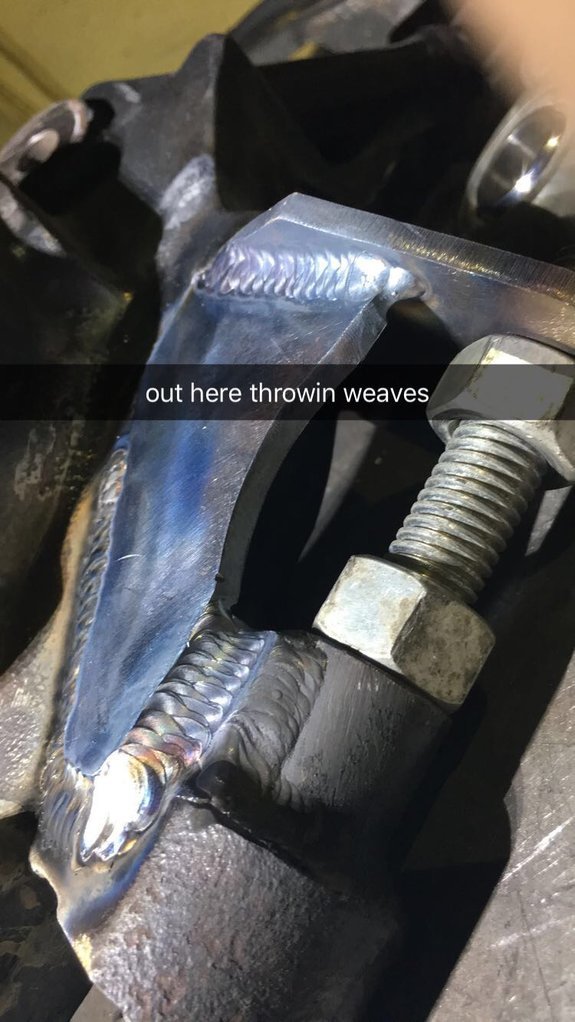

    Arb solenoid came. Good thing the compressors adjustable or it wouldn't fit where it's mounted. Also ran the air line to the rear end with the arb bulk head fitting kit and quick connect on the compressor side.
    Also threw this little TIG weave tonight.. not half bad :notsure:
