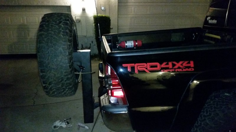

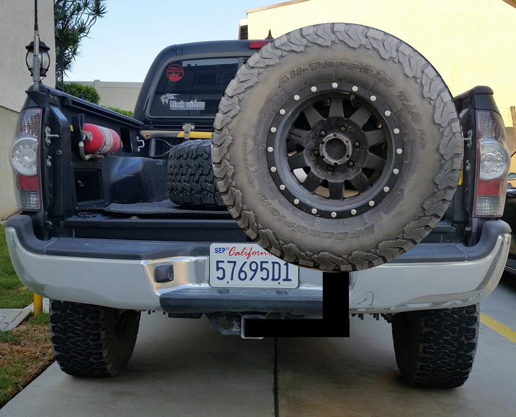

    Covered in stickers and chrome stick-ons for extra horse torques and foot powers. Icon sticker gets me tons of travel, dozens of milimeters.
    I'm at a customer site but I'll post some up later for sure! Yes @YotaGurlIAm the tailgate was stuck unless I pulled out the arm + gate and they are heavy together. I just left it in all weekend really. Hell pulled many a truck off it and it didn't even flinch! :rofl:

    Thanks denny. Looks beefy :benchpress: what gage steel is that?

    4"x 4" x 3/16"
    1/4" gussets
    2" x 2" x 1/4"
    1/4" plate for the lugs to hold the tire

    Used it to literally 3 Taco pull a full size 2 wheel drive Dodge in Pismo.

    If you have any complaints about a stiff rear end the location and weight makes it feel like a limo :rofl:

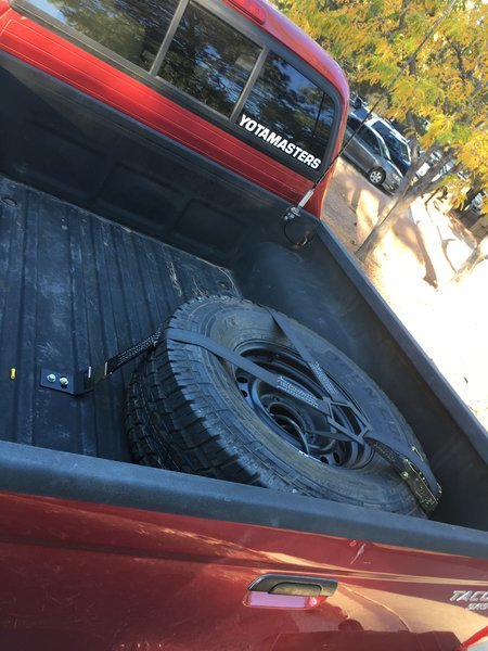

    Just finished mounting the last “mid” skid between ifs skid an the TG t-case skid with slight modification. Just need to tweak a few more things (countersink the bolt holding it in), and also mounted the spare tire via straps in the bed w/ a lock & cable:locked:

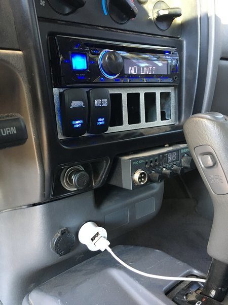

    Finally finished up the wiring last weekend. Paranoid fabrications switch panel with ottraw switches!
    Front light bar because those look best at the mall:D
