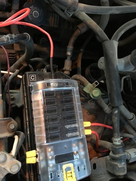

    Got the Blue Sea auxiliary fuse box wired up today... need to get heavier gauge wire running from the battery to fuse box thoughIMG_4175.jpg

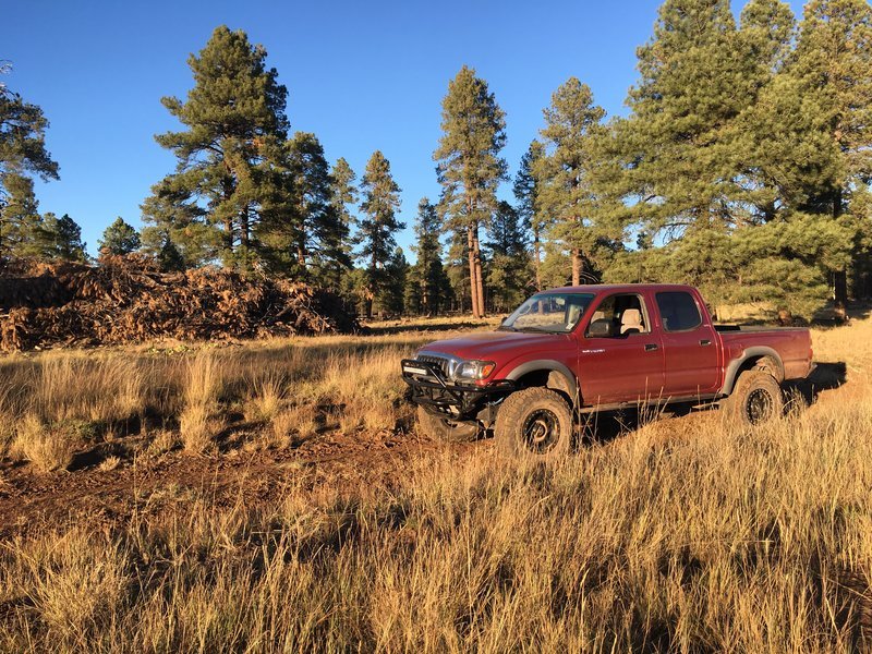

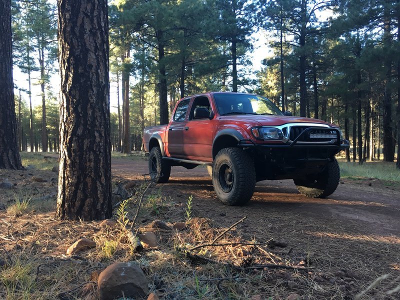

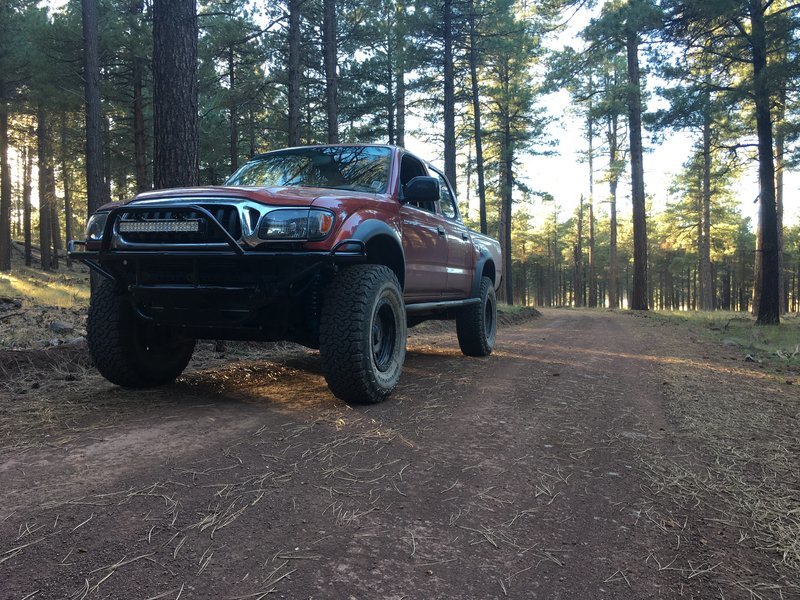

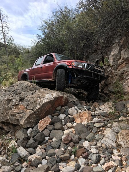

    Went to play with the new gps appIMG_4274.jpgIMG_4278.jpgIMG_4286.jpgIMG_4287.jpg

    I like where this is headed. Did you cycle you leaf pack and measure vertical travel with those 10" shocks on the BAMF kit?
    Probably also want a fuse or breaking in between the battery and blue seas.

    Yes, cycled shocks and measured bumps perfect. Took out nitrogen and only kept the largest leaf for cycle
    I do have a 100amp fuse breaker just have yet to install. Also need to add thicker wire in between the battery/blue sea

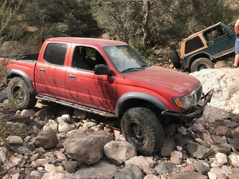

    IMG_4382.jpg IMG_4383.jpg IMG_4384.jpg IMG_4398.jpg IMG_4400.jpg IMG_4401.jpg IMG_4403.jpg Ran smiley rock today.
    Used every piece of armor and got some custom paint schemes going now :D
