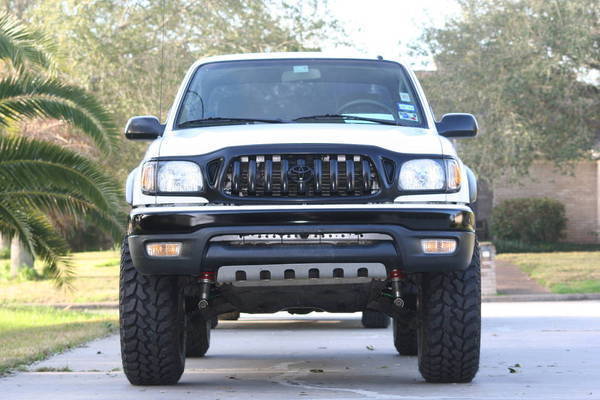

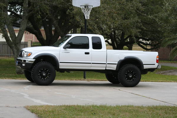

    I put the rims on and here is the result. The tires lifted the truck from 38 1/4 to 40 1/4, measured from the ground thru the hub to bottom of fender. The tires are close to the UCAs but not hitting, probably will on a full or moderate flex. But I will be going slow. No trimming on the fender wells, but I did flatten the pinch weld. The tires are 285/75/16 Firestone Destination M/T

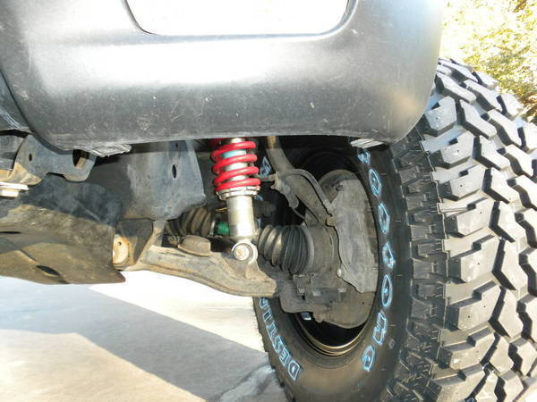

    This is a picture of my CV joint at full lock after the lift. I have the frt diff drop on from the Toytec Ultimate. What do you think? EDIT I did end up lowering thelift 3/4 in to keep the CV angle down

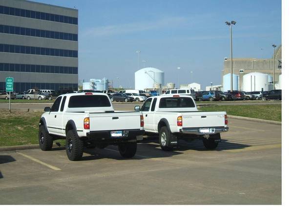

    Here are some pics of an 04 Tacoma Lifted and Unlifted side by side. They are both SR5s and 4 X4
