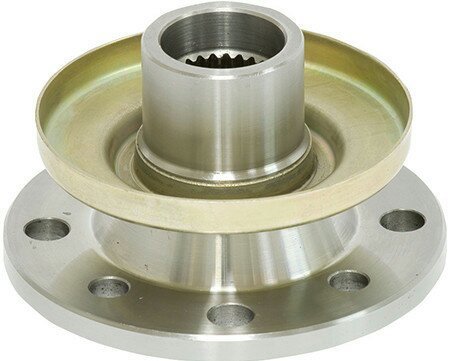

    There's no "crush sleeve"... You may be referring to the dust guard that sits between the yoke and the seal?
  2. Dec 9, 2015 at 5:10 PM
    hacklerjason
    hacklerjason hACKman's Customs
    Feb 9, 2013
    #97108
    1,688
    Jason
    Ewa Beach, HI
    2016 Chevy Colorado Duramax Turbo Diesel
    BajaKits UCA King 2.5 Extended Travel Remote Reservoir, Compression Adjustable (Front) King 2.5 Piggyback Reservoir, Compression Adjustable (Rear) American Racing AR910, Gloss Black PC
    This isn't the exact part but its the same thing for another make and model... Is this what you mean?6856874817973e2668edaa7a6e0eef5e_e846c59717d3ec34e4f9644a4b0b79e1604aabb8.jpg

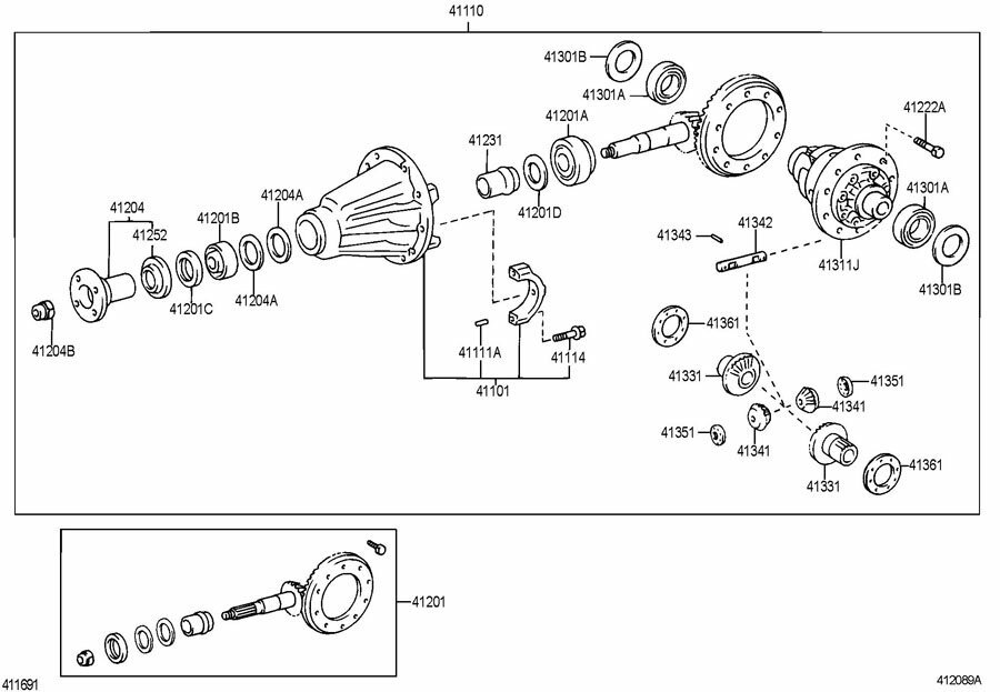

    You know what @Vigo, I have to stand corrected... There is a collapsible spacer that goes between the bearings... Here is a photo of the rear end on our trucks... Its item "41231" in the image

    "No crush sleeve" is what I said never have... But upon closer inspection of my higher reading materials, found that there is a one-time-use bearing spacer that is to be discarded and replaced when major repairs to the pumpkin are made... But for just the seal not a big deal as long as the nut is torqued properly
  7. Dec 9, 2015 at 5:37 PM
    hacklerjason
    Feb 9, 2013
    #97108
    1,688
    Jason
    Ewa Beach, HI
    You actually set up the gear mesh first, then install the spacer... Since he won't have the pumpkin apart aside from the nut and flange, no need to mess with all that

    Yeah, that thing-a-ma-jig that I didn't know the name for. To do it "properly" pulling the axles and third and dropping the driveshaft and removing the pinion to change the collapsible spacer didn't sound so Ez peazy. I just thought that you didn't mention marking the pinion nut before backing it off, it should be mentioned so that he can get it as close as possible to the torque when the gears were set up. If had solid spacer and shims then wouldn't matter, right?
