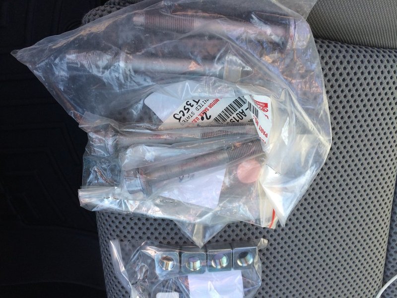

    So I asked for uca nuts and bolts. Does this look right? I just want to double check before I run out of time.
  2. Feb 4, 2016 at 11:57 AM
    jimbo808
    jimbo808 Well-Known Member
    Sep 5, 2012
    #86337
    689
    Kapolei, Hawaii
    05 TRD Sport 4x4
    Debadged, Mbrp cat back turn down, Afe drop in filter, Icon extended travel, Light Racing ucas, Dakars, Icon 2.0 vs monotubes, 285/70r17 goodyear kevlar Mtrs, Morimoto Minis D2S' bhlm with blacked out bowls, Bamf Sliders, pelfrey single hoop front bumper, smittybilt X20 10k, pelfrey ifs skid, pelfrey trans skid, all pro rear with side plates, sway bar removed, front superbumps, Avec 20 inch light bar, rigid flood fogs
    looks like the wrong stuff if you're talking about the long upper control arm bolt. One long bolt and one nut per side for the ucas.

    No those are for 5 lug UCA

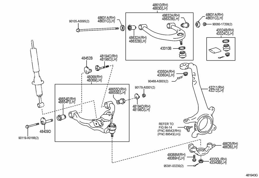

    This is what you probably need.
  6. Feb 4, 2016 at 12:13 PM
    hacklerjason
    hacklerjason hACKman's Customs
    Feb 9, 2013
    #97108
    1,688
    Jason
    Ewa Beach, HI
    2016 Chevy Colorado Duramax Turbo Diesel
    BajaKits UCA King 2.5 Extended Travel Remote Reservoir, Compression Adjustable (Front) King 2.5 Piggyback Reservoir, Compression Adjustable (Rear) American Racing AR910, Gloss Black PC
    You need per the drawing
    2x 90105-A0095 Bolt
    2x 90080-17208 Nut
    And if you bust up the washers by accident somehow
    4x 90948-A2002
