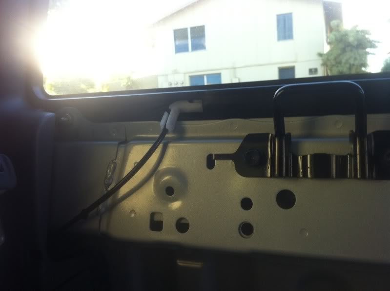

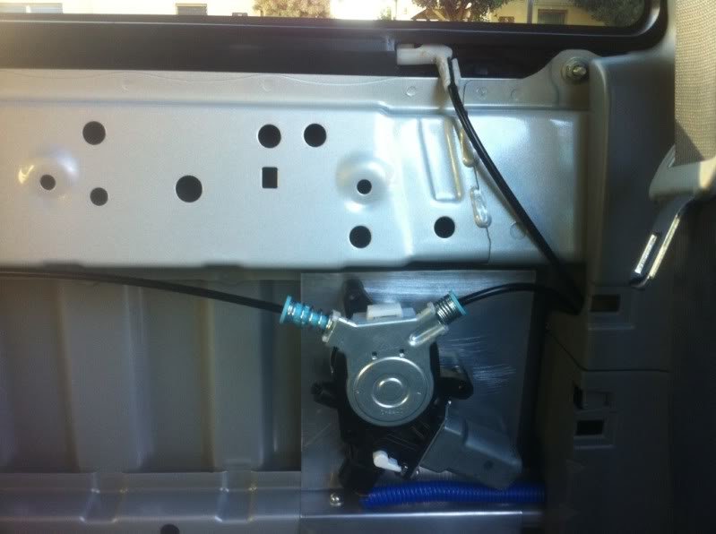

    After a couple weeks of gathering supplies and what not, planning it out, reading through various infos on TW. I finally got to install it and got it working. It was pretty much a bi*** and PITA to do. Lots of mistakes that I had to correct a couple times. I didn't have the proper tools that I wanted or needed, but I made of what I have. Dremel tool goes a long way hahaha. It's not 100% complete yet, cause there's various things that I need to tweak. Not to sound selfish and what not, but there's no way I'll do a write up on it. This thing was pretty much a trial and error, either it was going to work, or a big failure on my part. Hopefully I don't get flack for it seeing that there is member here that pretty much got this thing down. If you guys do have question(s), I'll be happy to answer them.
    here's a not so perfect video haha:D. you guys got the idea
    http://youtu.be/wIz_PSbEO8Y

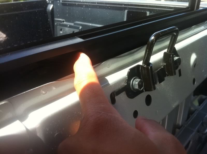

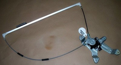

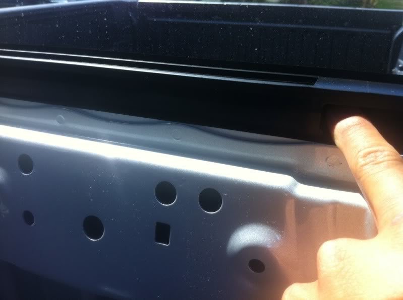

    Thanks man. It ain't perfect but it'll get there.
    Most likely I'll just put the switch where the 4x4 switch is suppose to be, since I don't have it. As for the latch I'll prolly just disable it instead of removing it.
    Here's a list of the parts that I use.
    Honda Ridgeline rear glass regulator. It's a lot cheaper to buy it from a honda parts web site than eBay. Got mines 62.93$ shipped.
    Switch- got mines from eBay. There's so much options out there. Your decision on what switch you wanna use.
    Bicycle break cable, and cable housing. Got mines from the bike shop in aiea.
    Then you need wires. Got mines from RadioShack.
    The hardest part of this thing is that you need to fab your own bracket that'll clamp on to the rear glass. Second hardest part is finding a way for the cables to hook on to the bracket. That's why I said it was bi*** and a PITA to get this thing done.
    Since you have a DC, It'll be your decision on where it's best to mount your motor.
    Regulator
    c4c159fd32c5d3a55cfe2072b47eb4f9_zps961b_ea48f488ac0c5f6a9fe4c9546053daf7d327f675.jpg
    This is where I ran the cable on both the passenger and driver side. There's like this open gap, drill a hole and ran the cable. 7D1526DD-E09C-4D74-A112-FD0276C0FADB-538_0e28ec50db7439b06038464c0f008a7eaf8e8cf6.jpg38CE9B99-C9A0-4BC7-9325-5439568C8D4F-538_59ed6642cb08eaaa7a276745a9d447fbcd4e15a4.jpg
    Mounted the motor on a piece of aluminum plate, drilled 2 small holes, and use the smallest nut and bolt I got lying around.
    A1BDE788-3021-428C-BD83-6761A1500B80-538_90fb1fcacaa758fe834bd2c38fb9eac37a1c10b8.jpg
    ECB432C2-9249-4B2F-A1B2-586832162CD1-538_a6a3d789e32362689097fba64815d2b35d8fa118.jpg
    It's not as detailed as it should be, that's why I don't want to do a write up on this thing. But you'll have an idea on how everything goes. I'm pretty sure anyone can do this, if they have the proper equipments and tools. Anyone can tweak some of the stuff, if it's easier to do it this way and that way blah blah.
