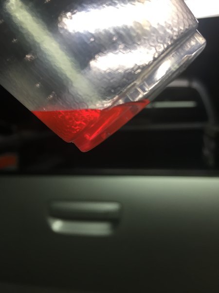

    hey guys need your help. I did a coolant flush maybe 3-4 years ago because i topped it off with some walmart stuff and i wanted to replace with all toyota. It was on the min level on the reservoir about 2 months ago so i topped it off with more toyota coolant. present day it lost about a centimeter in the reservoir. I checked to the radiator cap today and it's brown. What you guys think it is? I checked the oil and it looks good.

    get a radiator funnel and idle the engine while watching the coolant flow?
    what color was the walmart fluid? its possible that the brown color could be a mix of the red and green/yellow?

    the walmart stuff was green, I'll try the radiator funnel as long as i can find it or I'll buy one tonight.

    its hard to get all the old coolant when you flush, so hopefully its some of the leftover green

    hopefully that's it. now i'm wondering why I'm losing so little coolant so slowly. Maybe the coolants going bad? It has been like 70-80k miles since I flushed it.

    if it continues to drop, you may have a leak...head gaskets are not fun, but it looks like there is enough room to work on it

    my eyes must be playing a trick on me but i checked what color it was with a flashlight to see and looked more pink. so i took some out to take a better look. I'm hoping it's just the cap that's bad.
    i forgot to add that after the engine is all warmed up, the reservoir has a small smount of bubbles, not constantly though coming from the rad cap into the reservoir.

    Looks normal color . If you got leak the pink kind of makes it easier to see . Look for pinkish white type stains.

    I would keep an eye on the bubbles in the resi. You may have the beginning stages of a bad head gasket.

    thanks, I'll keep an eye on it. Gonna get my oil tested at blackstone lab and hopefully no coolants inside.

    Oh yeah, that's a good idea. You can even let them know, in the comments, what issue you are trying to figure out.
