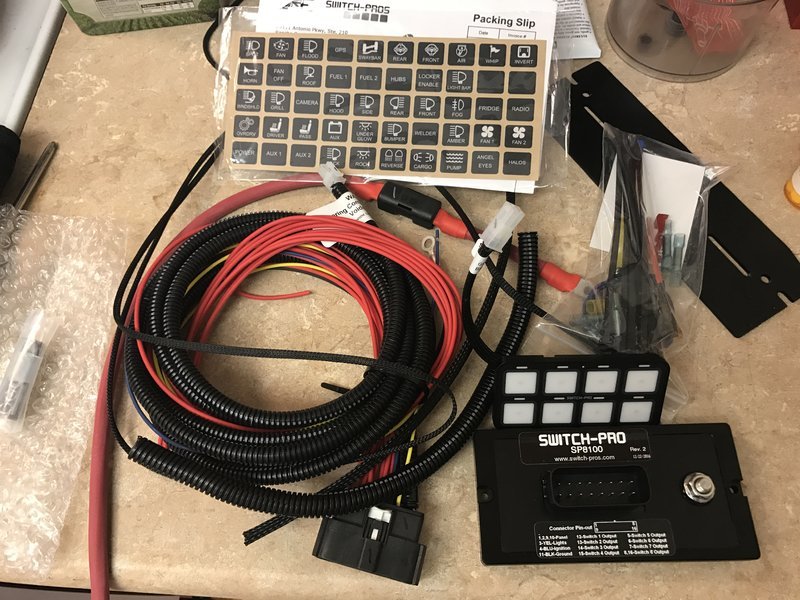

    @seoulja99 this should answer some of your question(s). As for it being waterproof that I wouldn't know because the only thing that would be exposed to the element is the 100A rated power module, which is sealed. As for needing a separate fuse box pretty sure that's not true(please correct me if I'm wrong). 8 total programmable switches; 7 rated @18A each and 1 @ 30A.

    For higher amp accessories I believe you still need a separate fuse panel. Just curious, if a switch-pro circuit overloads, is there an internal fuse or something that blows?

    Got this from the description.
    •Automatic shutdown for overcurrent and low voltage.

    Pick me pick me pick me! How many circuits you need to run? And might I suggest that if you have circuits that need higher current, you buy a relay bank and piggy back that off your switch pro... I don't know what the max loading is for that thing but I would say anything higher than 10 amps should have a relay anyways

    Well I don't know if this will make sense to you, but I want everything pre hooked up
    So when I get more accessories, I can just hook up and everything will be okay.

    Does the swing out come as a kit or gotta fab it?
    I can do it that way if you wish.. I don't know how I would terminate the harness for you since we won't know how the new additional stuff comes and I don't know if you're equipped to make OEM type connectors... I can pre terminate with insulated female spades so you can just put males on your new stuff and plug in... Thats super doable, just lemme know how you want it terminated so I can put a parts list together for you to order so we can get this started.. I have supplies to get started but I'll need replens..
