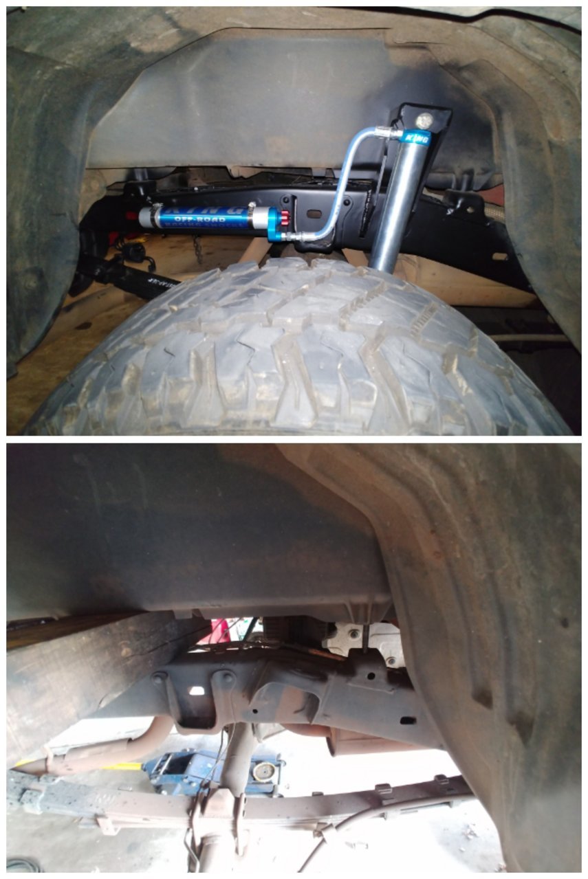

    Not true! I ordered my plasma just for jobs like this and I can assure you it did in fact help

    I still had to punch the rivets out but I didn't have to drill at all. I plasma gouged the heads of the rivets and the remainder punched right through. The plasma also makes fast work or cutting off the oem shock mounts to make room for relocation brackets
    The big deal is that the factory brackets are too thin and will eventually bow outwards with even normal use. Bigger brackets negate that
