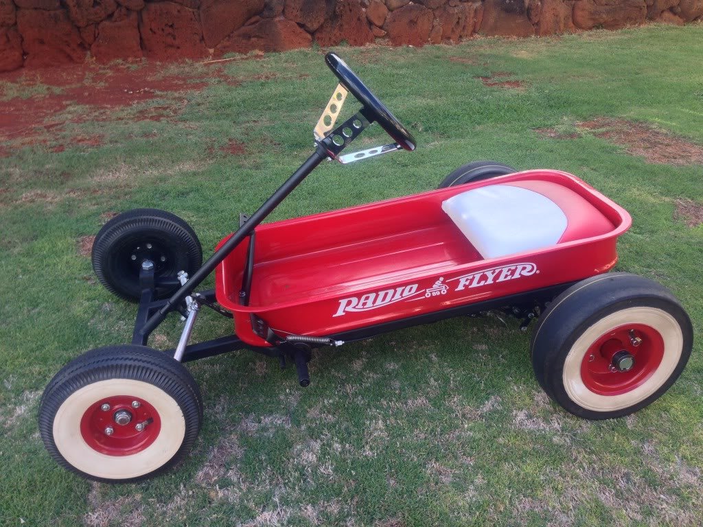

    I build an electric go kart for my daughter. It doesn't have a solar panel but its fast :)
    a 24v 350w electric scooter motor overvolted to 36v, it uses (3) 12v 10Ah SLA batteries. Live axle, uses a hall throttle box for real working throttle pedal, and disc brake.

    brah thing is cherry, how much would you charge to build another one? would like my son to cruz that thing at bbqs...PM me lmk if its possible

    That red wagon is pretty badass!

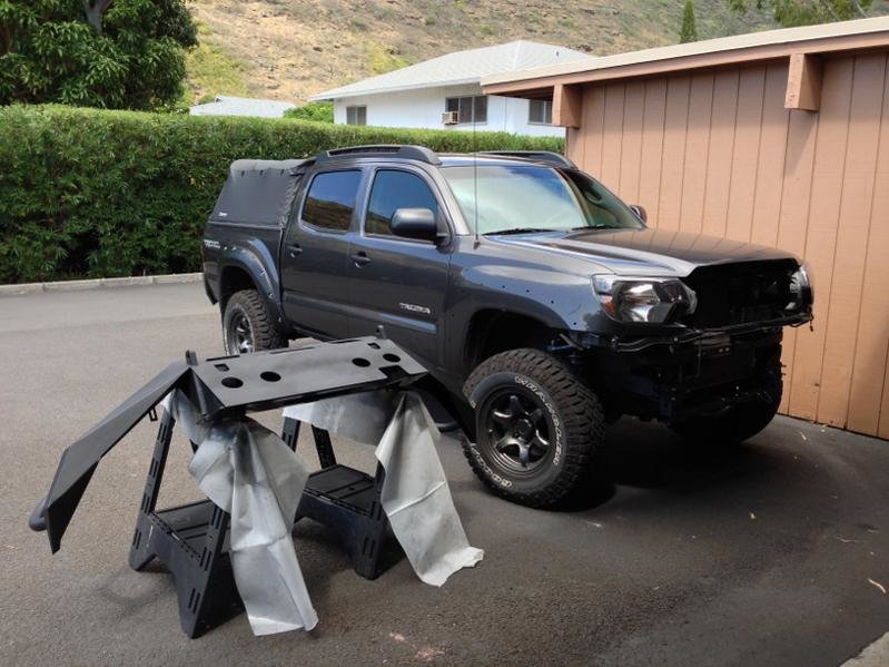

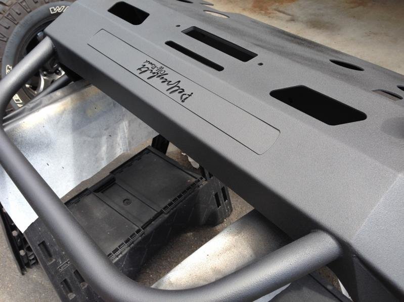

    Took a day off today so I could spray my bumper with the duplicolor bedliner. Looks pretty good! I've used this stuff on my Monster Mule project on the floor of the cab and really liked it.
    My makeshift spray booth :D

    looks good! :)

    Looks great! I think that's what I'm going to spray my bumper with.

    That thing is bad ass.. Maybe we should do a wagon mod day and you can help all of us make one for our kids.. lol.

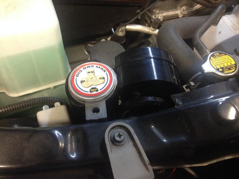

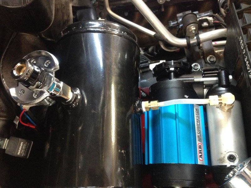

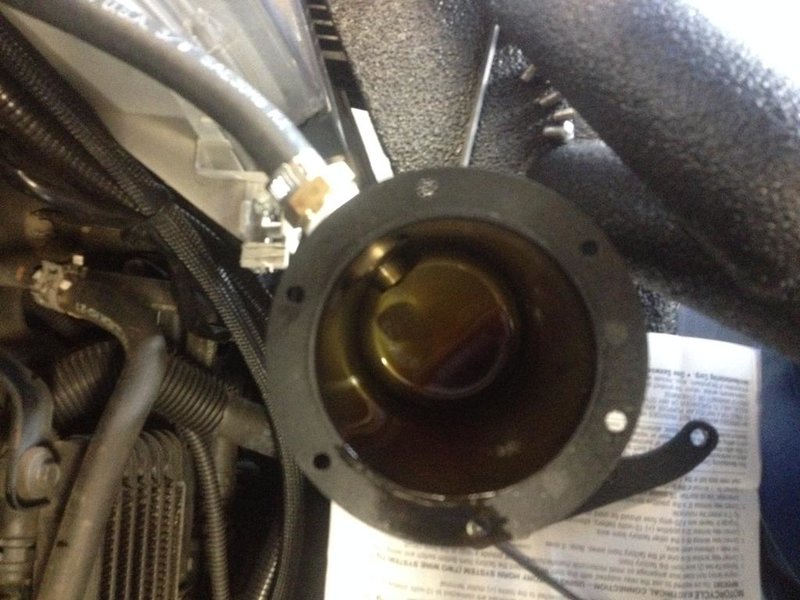

    Finally empty out the oil catch can after 1200 miles since installation this is what came out of the Oil Catch Can. Also installed my 1 gallon air tank next to my ARB Compressor and finally installed a Big Bad Max Horn. Need to start a build page lol :D

    That's a lot of blow by! How's the horn sound?

    It's ok louder then stock. Next week Sunday you can hear it.

    Aiight. I might want to get a catch can too. Next group buy.

    I just found a new toy!!! That thing is bad ass! Can you write a build page for it? I would like to make one... Or buy on off of you...

    What is the is the reason you added a oil catch can to your rig? I have never seen one of these.

    It is installed between the positive crankcase ventilation (pcv) valve and the intake manifold. All the vapors including oil and water mist are sucked into the engine for combustion. This is for emissions, and all the oil can gunk up the intake tract, valves, and even a supercharger if you have one. On some cars it gunks up the idle air control valve, depending on where it is re rerouted into the intake tract. The catch can filters out some of the oil and water via a mesh or screen and cooling of the gasses.
    Blow-by, caused by pressurized gasses going around piston rings, causes this positive crankcase pressure. Blow by can be greater with forced induction, so that's probably why he has one installed.
    I have one sitting on the shelf waiting to be installed...too many things going on.

    Thank you! Are they worth imputing an a non SC truck?
