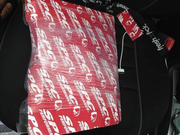

    Also got sumting in da mail...

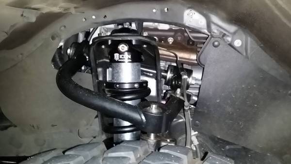

    Done finally! Was a long day but it's in. :D

    You almost got your whole set-up now. It's always awesome recieving mail like that.:cool:

    Did u buy a new uca bolt?
    How hard was it to get out?
    This is jus a piece of my lift. I'm saving up for they suspension parts so i can buy dem all 1 time save on shipping and more waiting/anticipating.

    I reused the original bolts but I had to bend/cut the passenger side sheet metal in the fender to get the bolt out. The driver side was easier, just had to bend little bit to get it out but harder to get back in. I put the passenger side in the opposite way and it went in pretty easy. I just bent the metal back after I put the bolt back in.
    The hard part to me was trying to squeeze the uca bushing washers in there. That I had to use a pry bar to make space for the washers. I needed my wife to help hold the UCA in place while I manuvered the driver's side bolt back in.

    That's as far as the taper pin seats in the spindle. Maybe it's because the uniball is recessed in the UCA. I saw that too but if the spindle was closer it would bind against the UCA. The truck drives great.:D
    Edit: Now you got me worried. Lol. I hope that's as far as the tapered rod can be seated in the spindle. I'm going to go check now. Lol

    I went out to take a look at the tapered rod and that's just how it is. Now since I just looked at it, I should have painted the top of the spindle before it starts to rust.
