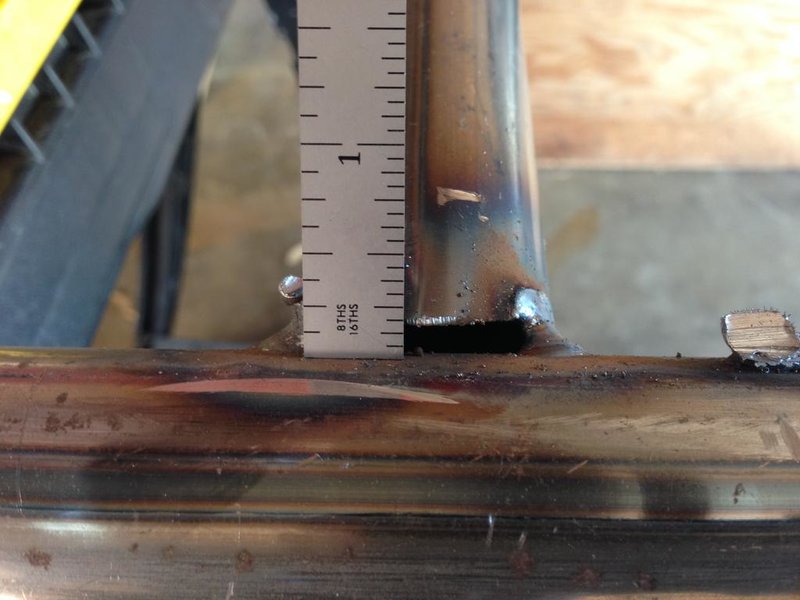

    Looks terrible! I feel for you, waiting so long and wanting them so bad. What a let down!
    I think even my sketchy welds would be stronger. Doesn't even look like he believed the tube ends? And seems like the plate was only tacked on.. I can't even understand why it would be easier/stronger to do the plate first. And if he is cutting corners like that then why did it take so damn long..
    Should be good once they are fixed. The tube looks quality, just the welds that are wrong.

    That sucks Iven, if he does all of them like this that is kinda F'd up. I would post the pics and his responses in his review thread. All sliders are fully welded, but it's not necessary for strength if the notches are done correctly. Tubing structures depend on the fit-up and design for strength, the welding is there to keep the pieces in place. There are a lot of roll cages that are not, and can not be fully welded, but they are made correctly and hold up to all the abuse you can throw at them. BTW, I'm not defending him because those look half-assed to me.
    I might be welding some brackets on my neighbors Vanagon Sun. You want to try out an ESAB? :D
    It's .120 wall tubing, there is no need to bevel unless you're using a 100 amp welder.

    Nice fit up, huh? :rolleyes:
    And yeah full bevel in not necessary in this case, but I'd rather bevel this a little and then TIG weld it nice and tight with a good cover pass.

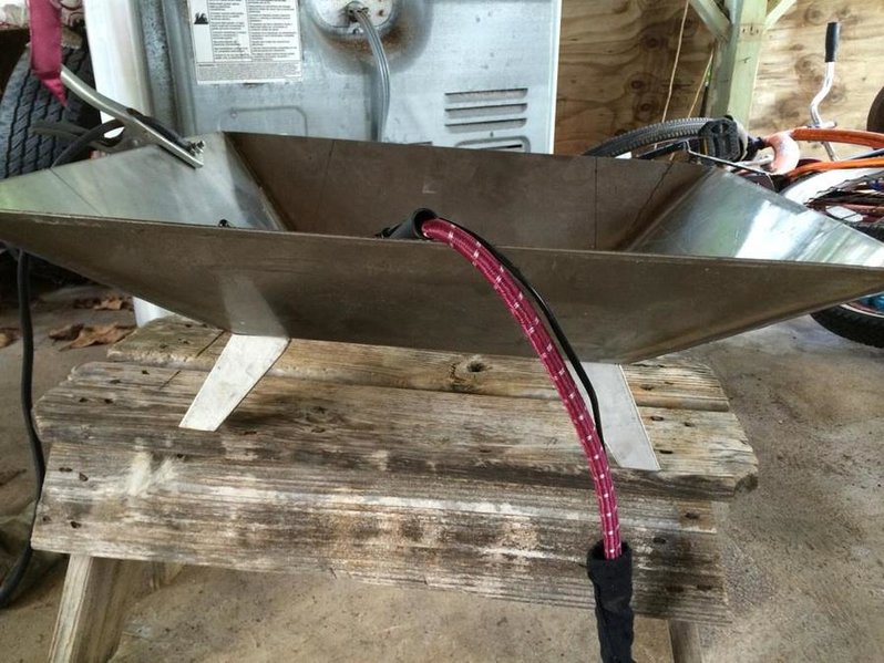

    This is the firepit I cut and formed at work with 1/8 304 plate. My buddy who welded my hoops is welding it for me. He's not a journeyman yet, but he can TIG pretty damn good.
    Should be nice to sit around at peacock flats :)
