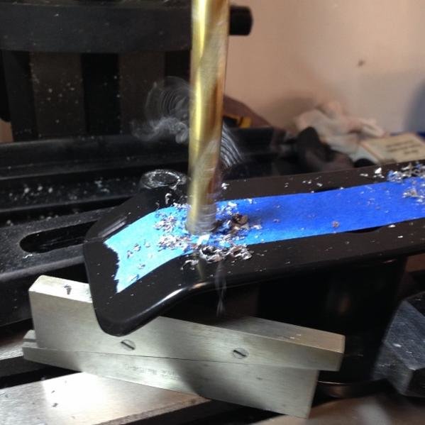

    There were questions earlier about the U bolt flip working with the Superbumps, so I thought I'd post a few pics. For Rick, I suggested the U bolt flip since it looks cleaner, and wont damage the threads if you drag anything. I also suggested the Superbumps even tho they don't work with a flip kit because most people feel the Timbrens have too much rebound for off roading. So the Superbumps are better if you don't carry a lot of weight in the bed. I also have the U bolt flip and Superbumps in front, and was working on a solution for a long time for mine, but never got around to doing it. Obviously its much easier with the kit uninstalled.
    Anyway, Just lay it out and drill the bracket,

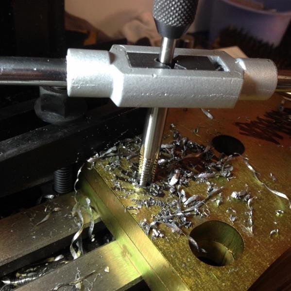

    Drill and tap the top plate,

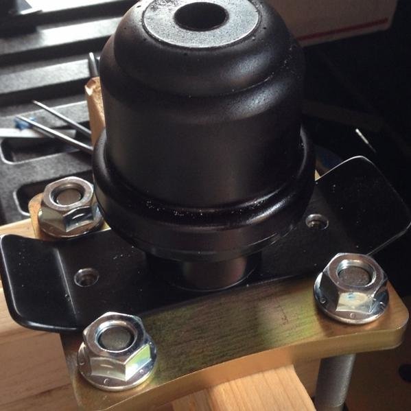

    And done! The bracket fits perfectly between the nuts.
    This way, you don't need to mess around with loosening the U bolt to replace or adjust your bumpstops.
    Pretty easy! ...if you have a tiny machine shop in your garage :D
