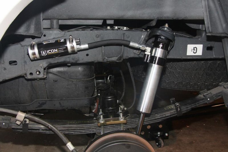

    Till Iven chimes in...yes I put on the 3 leaf AAL in addition to the existing ones's. A 9" U-Bolt will still be long enough to wrap those and you'll still have to trim it down. You're using the U-Bolt flip right?

    Just measured from the bottom of my axle to the top of the U-Bolt and it measures 7 1/2" as it stands now. I still have about 1/2 - 3/4 of an inch of thread above the nut. And that was trimmed down from the original...

    Yeah have an option to get the 9" bolts or 10.5"($10 more). Also getting extended rear brakelines. Come out around $140 shipped.

    Unless you plan on slapping a block in there to raise it another inch as I plan on doing, with 9" you would still have enough thread to make it work. Save the cash and get the 9's...

    How big is your leaf pack setup now? I have ome u bolts now and im pushing safety with about 2 threads showing.
    Edit: just measured my u bolts their 7.5".

    So the 9 should work for you then..

    Shootz ill go with the 9z an if need later ill get longer bolts.
