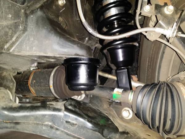

    Got my super bumps in.
    Thanks for bringing it in with yours Kaleo.:cool:

    Looks good bro. How was da install?

    Wasn't too bad. My truck had just enough droop to use a shorter allen wrench to get the bolt started and then I could finish bolting it in with the long one that they supplied.

    Yeah, i read sum post wea guys cut down da wrench.
