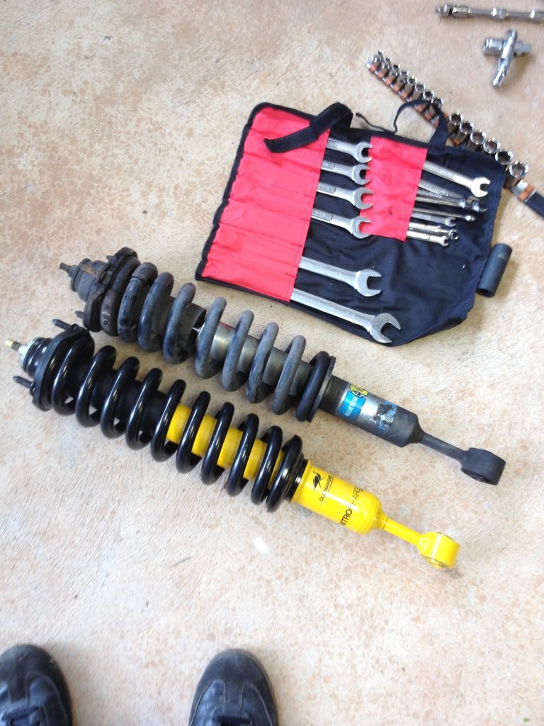

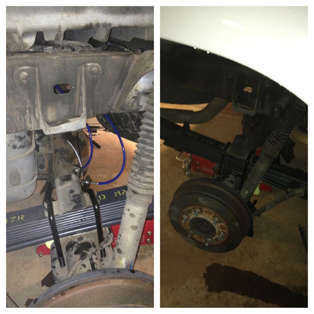

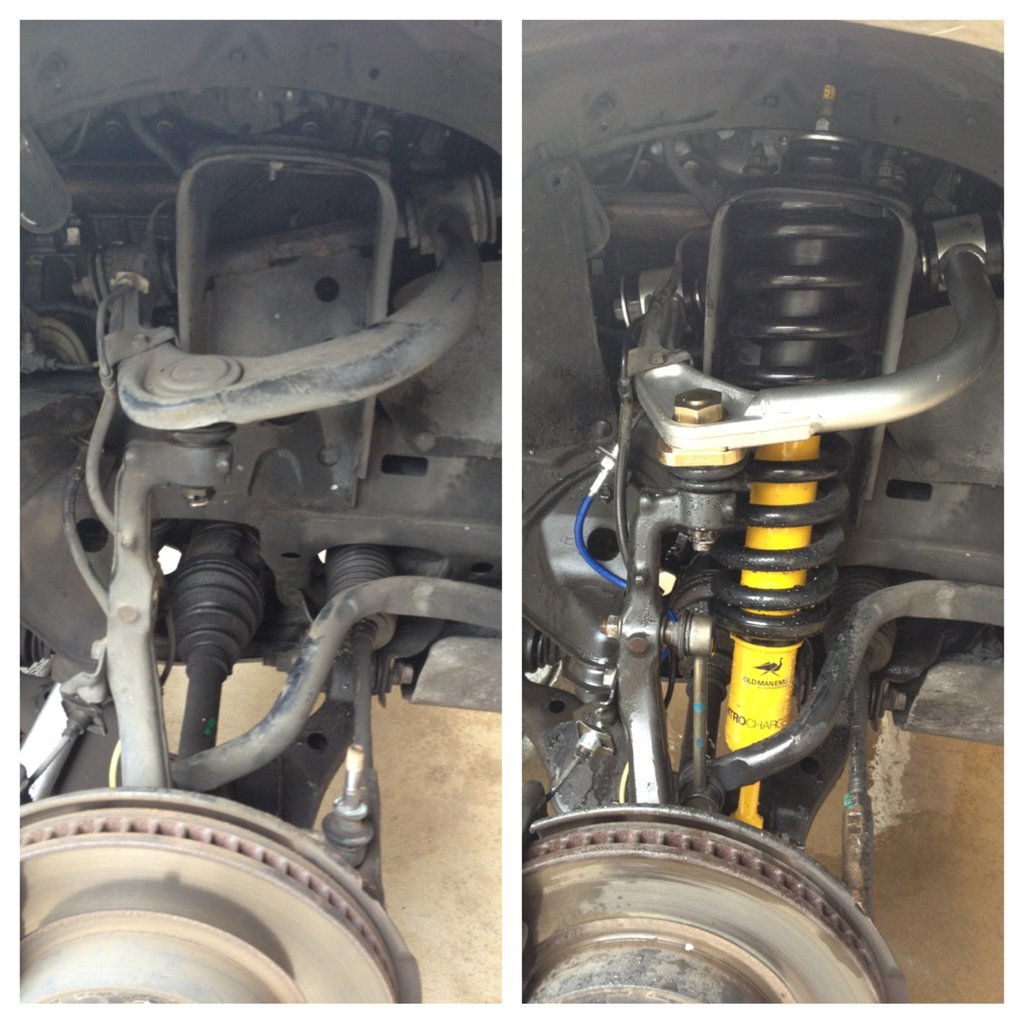

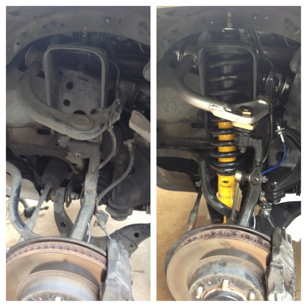

    my "fun" for today.
    Worked non-stop from 10am-8pm in the constant rain up in Wahiawa
    No lunch break, no bathroom break; Yes I slave-drive myself, it's better that way :)
    Installed:
    OME 90000 fronts with 886x springs
    SS braided lines
    LR UCA's with spec-ride bushings
    Dakars+AAL
    OME CB drop

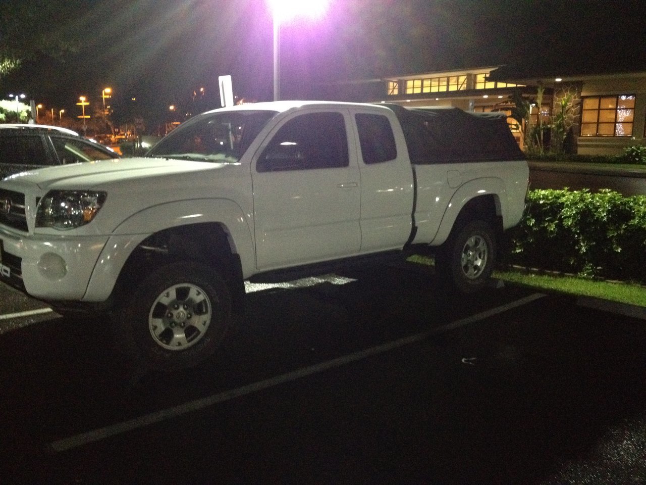

    and how she sits now;
    On the long drive home, didn't notice any vibs...It had a slight pull to the right on the highway which is expected, i'll get getting an alignment soon.
    Took initial measurements, but there is a bit of a load, so i'll clear out everything and let it settle before posting the findings.
    :cool:

    Awesome! I bet it was worth all that work :)
    It look great now! All you need to complete it is that trans-transfer case combo :D
