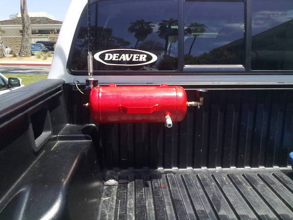

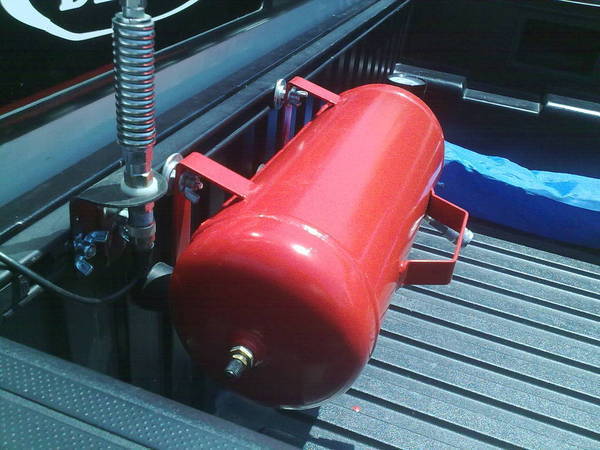

    Thoughts.....
  14. May 19, 2011 at 8:56 PM
    92LandCruiser
    92LandCruiser Well-Known Member
    Feb 20, 2010
    #31761
    8,324
    Nevada
    80 series Land Cruiser
    Cummins, tons, 40s
    Do you have a compressor rigged to that tank? You'll drain that quick doing anything.

    Just asking for the tank to get jacked IMO. Unless you install it with some vinyl lock nuts

    I have a 12v portable air compress that I can attach to the tank...or not. I thought about it getting jacked.....for that matter, I always think about my truck getting jacked....Heck - its a 2010 Tacoma Double Cab with Camburg and Deaver stuff on it. Sorta hard to live life that way though. I figure I have insurance, pictures and receipts. If they jack the tank...thats $40 bucks gone. They would probably take the CB antenna as well. Hopefully, they will still be messing with it when I return.

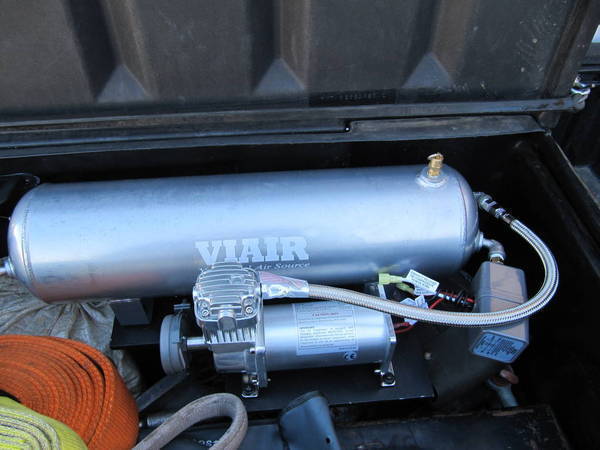

    Here is my setup that has been working well for about 3 months now. It is a Viair heavy Duty setup from Amazon for $385.00. I installed it myself but took most of the day and a half by building my own bracket to mount the tank and compressor on. But does quite well with air tools and using an air nozzle to blow down dusty gear from quad riding.
