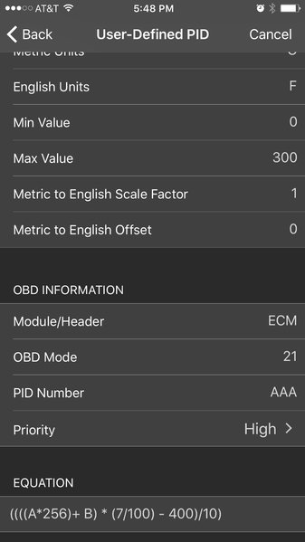

    I have been searching to solve this. The information is out there display the Trans Temp on the Scan Gauge and that info is below. Does anyone know how to convert the info to the format used by OBD Fusion?
    Gauge Transmission Fluid Temperature 1 (℉)
    TXD 0701221AAA
    RXF C462051A36AA
    RXD 3008
    MTH 00090005FFD8
    Name TF1
    Gauge Transmission Fluid Temperature 2 (℉)
    TXD 0701221AC0
    RXF C462051A36C0
    RXD 3008
    MTH 00090005FFD8
    Name TF2
    Here is one of the many combinations I have tried.

    Have u asked this obd fusion?
    If they understand the math, they may be able to give u a simple answer

    I sent email and have gotten no response.

    I appreciate the idea and it reminded me I had not gotten a reply so I resent again today.
