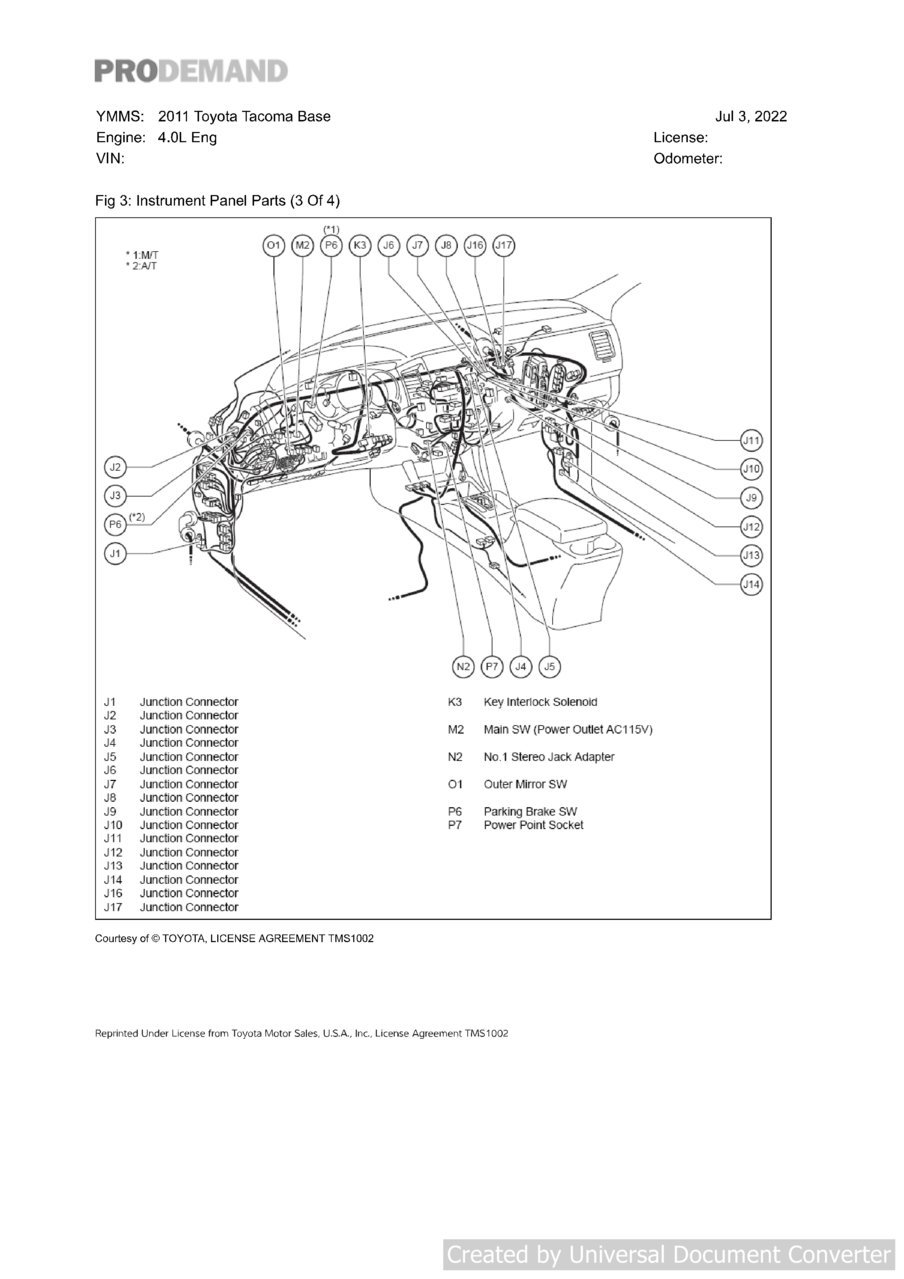

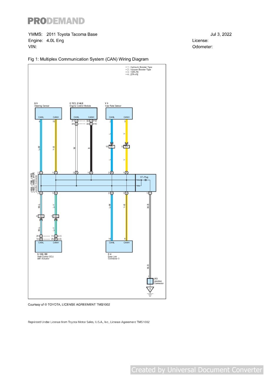

    Measure the resistance between pins 6 and 14 with the battery disconnected, it should be 60 ohms.
    If you have no other warning lights on I would have to conclude that the module to module communication is good and there's a problem between the DLC and the J9 junction connector.

    That suggests that the CAN lines are intact at least to the terminating resistors, not really much more you can do at this point without scoping the CAN lines or trying a different scan tool.
    I would be curious if you could talk to the other modules but I'm asuming you just have a basic scanner that can only read PCM codes?
