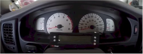

    Scangauge II is what I have been using.
    What I like is that this gauge can attach to a readily visible point on your dash console with any backlit color you want to program.
    I just updated their most current software 4.5, which gives you more "X-Gauge Commands"; a format allowing you to program protocols to read anything that the vehicle computer puts out.
    I paid $92 for mine a year ago.
    You can get a slightly used one on Ebay for less but will have to pay $25 to update the software. New ones start at $135.
    Here's where one fella placed his:
