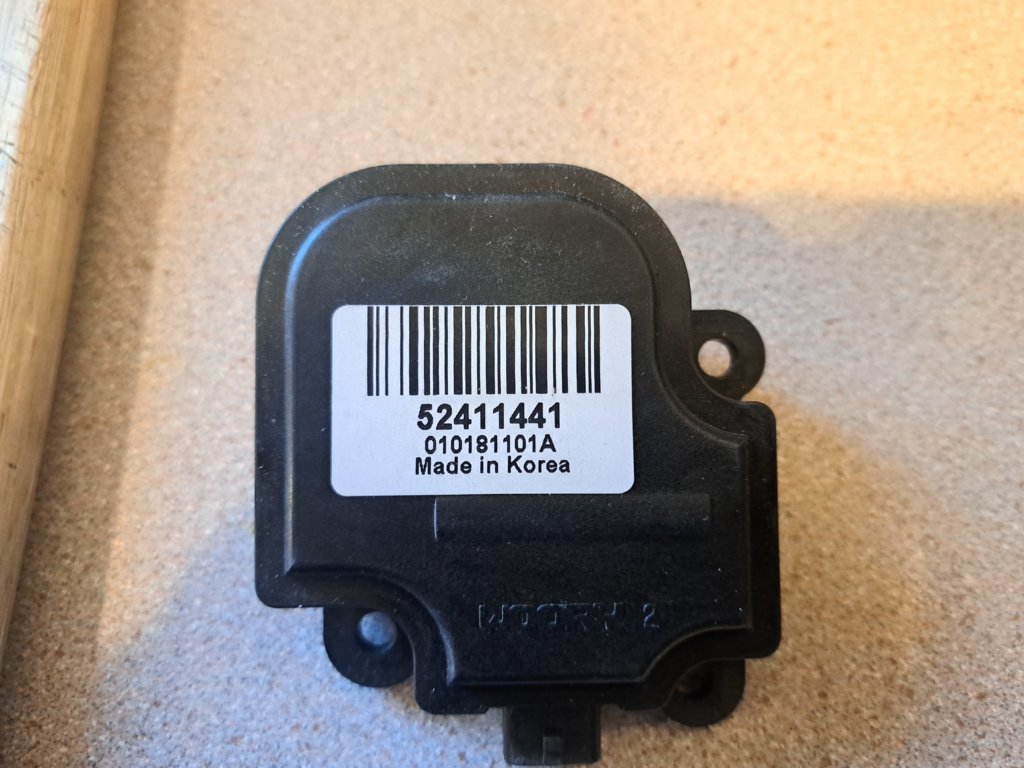

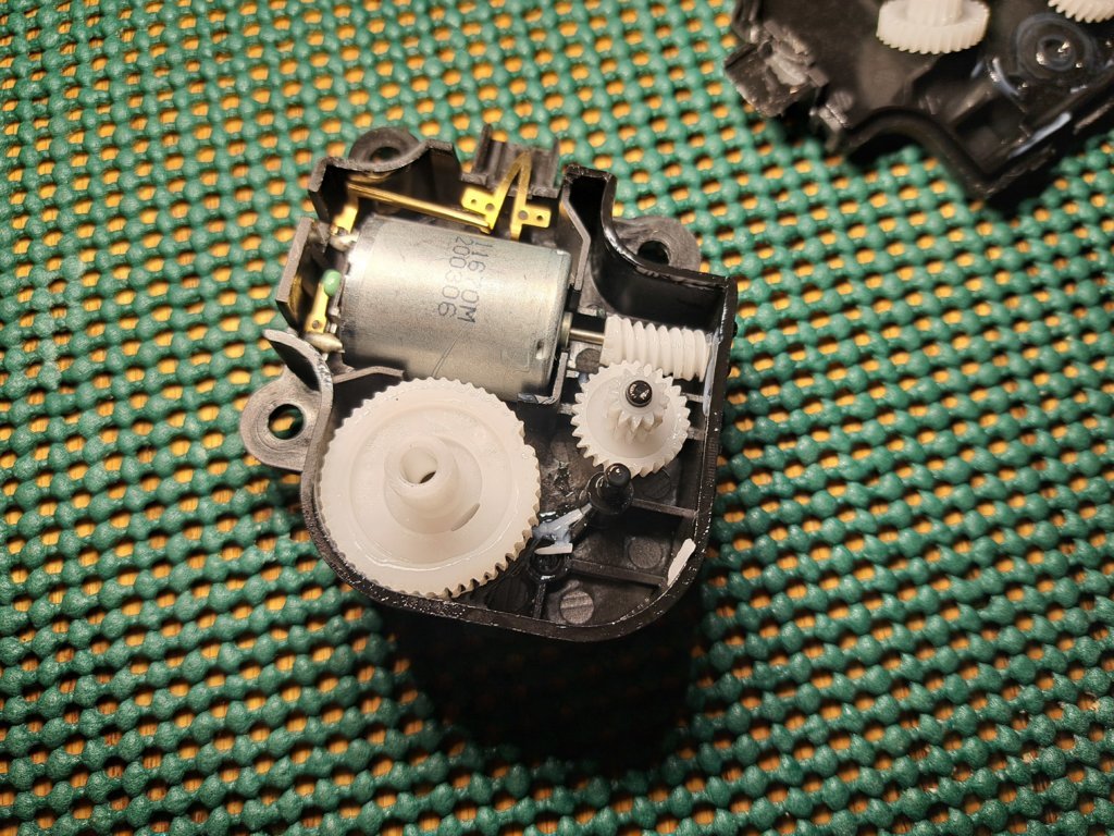

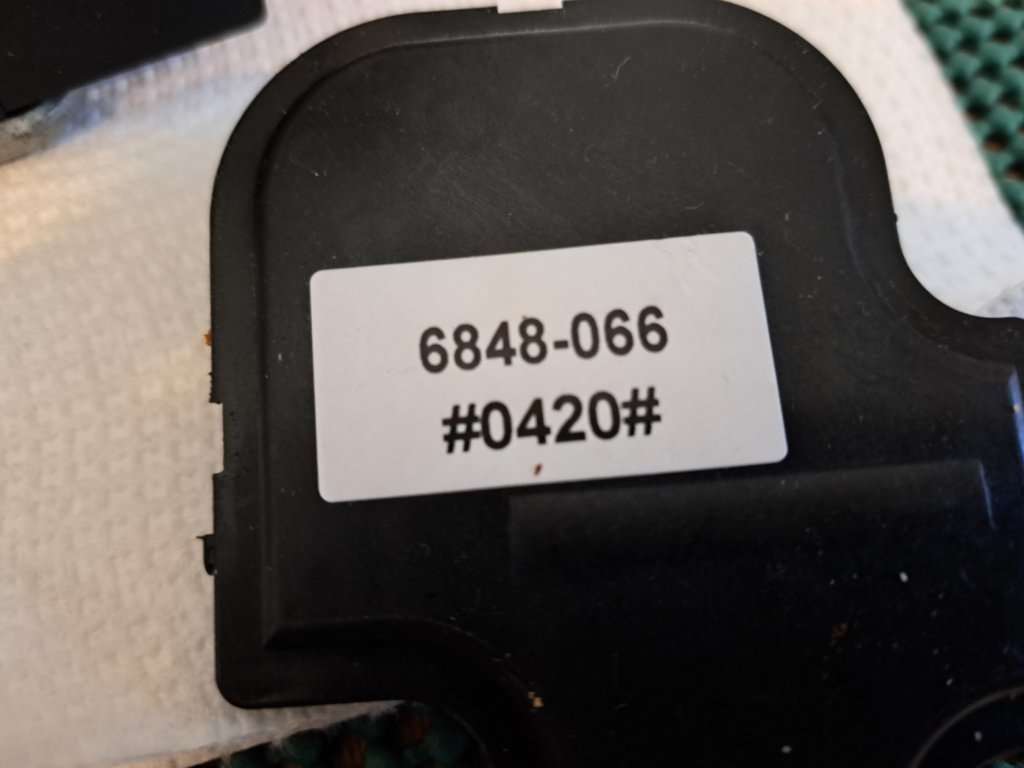

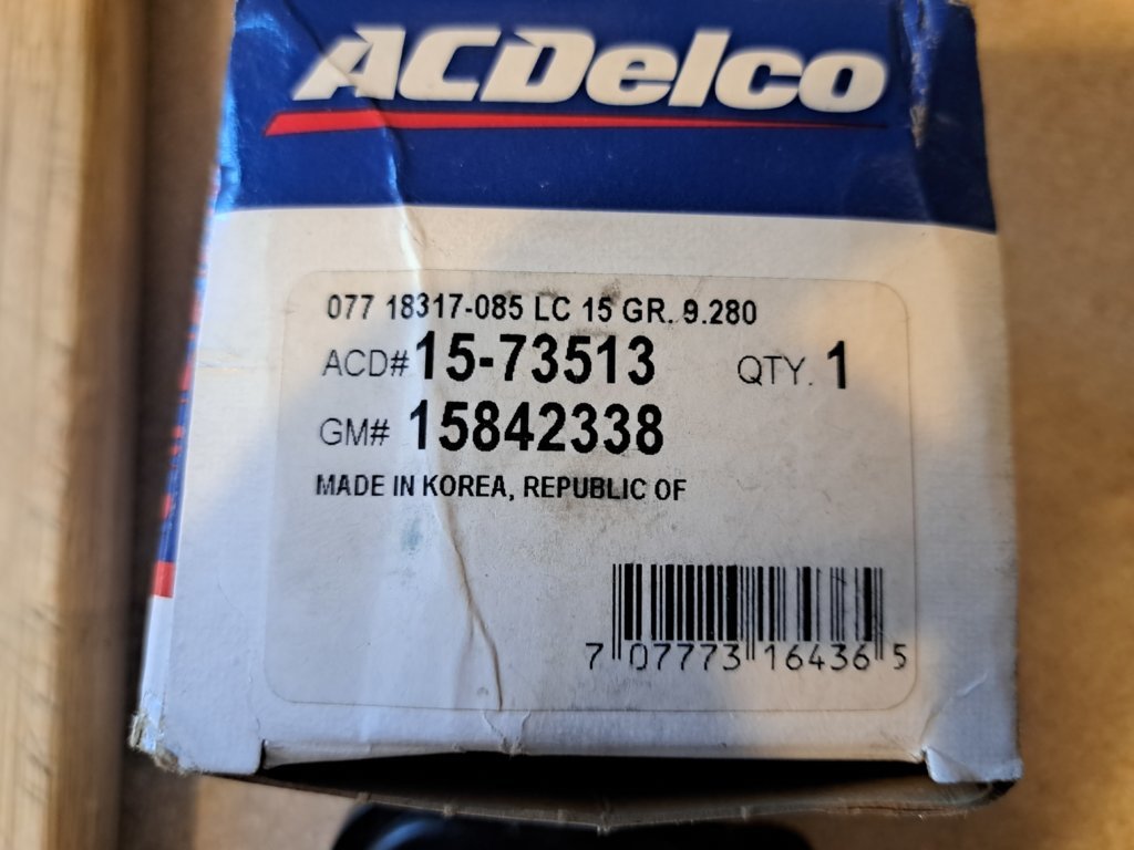

    UPDATE: So the Ebay part crapped out after 2.5 years (October 2024). Clicking noise again!
    Since I've been thru this I knew what I was getting into.
    New part from Amazon - AC Delco $45.65. Installed and working great. I'll update again if this craps out.
    Note: The OEM and this AC Delco are both from Worry so fingers crossed I'll get 10+ from this part.
    Pics of Old Cheapy from Ebay then the new AC Delco from Amazon
    Any questions - hit me up. Thanks again to this wonderful community of Taco Owners.
