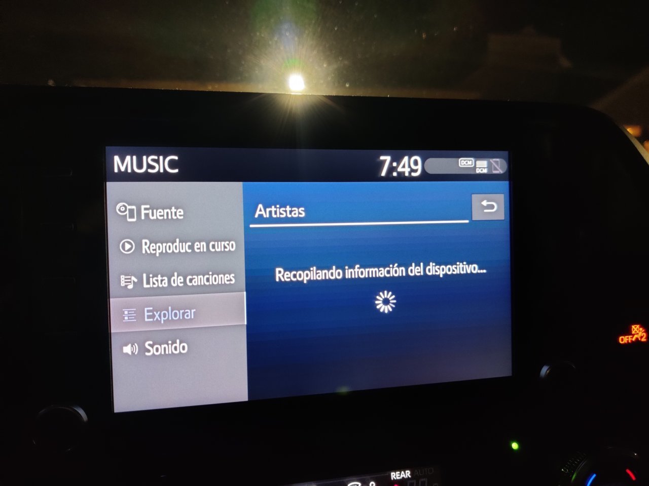

    Not a fan of the newer Entune system my wife's Highlander has. This thing takes 10 times longer to scan my USB drive (both initial and resume scan), and it ignores the album covers. Got to stare at this for 10+ minutes...
    Is that normal for the newer units?

    Mine does take a few minutes to scan the USB. However when it does scan it plays the last song it was playing while it does so. I can't change tracks until it is done. It is scanning about 230GB+ when doing so which I don't expect it to do quickly. The album art is hit and miss. You can tell it to prefer the graceDB or the album art embedded in the song. I rarely ever keep in on the music screen though so I don't really care. I keep it on the home screen with music as a sub screen with weather and the map. As far as the graceDB goes, that has never worked properly for me, I've tried to update it multiple times and it has never worked.[/QUOTE]

    My flash drive only has about 62GB on it. I have just a few files shy of the 9999 limit. It's all MP3 and AAC files.
    I did a test, timing from when the song starts playing from the previous trip to when I can select another other song to play.
    My 4Runner only takes 10 seconds.
    My wife's Highlander takes 52 seconds.
    Not horrible, but it was the initial scan in the Highlander that takes forever. The first track that plays is a 1:43 comedy track, that I had to listen to a dozen times before anything else loaded.
