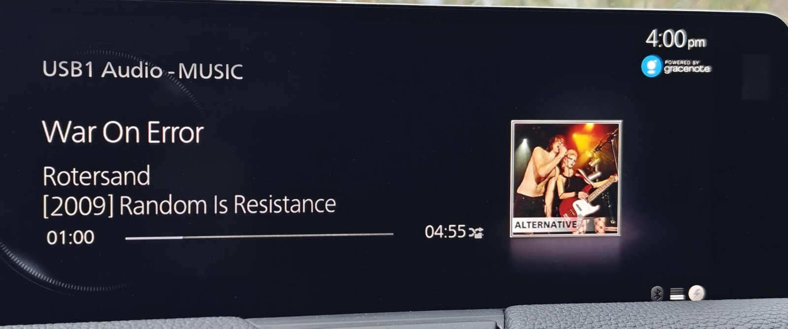

    I thought these generic rock, alternative, world etc... images were part of Entune, turns out they're from gracenote. I have a rental Mazda that seems far more picky about the embedded album art.
