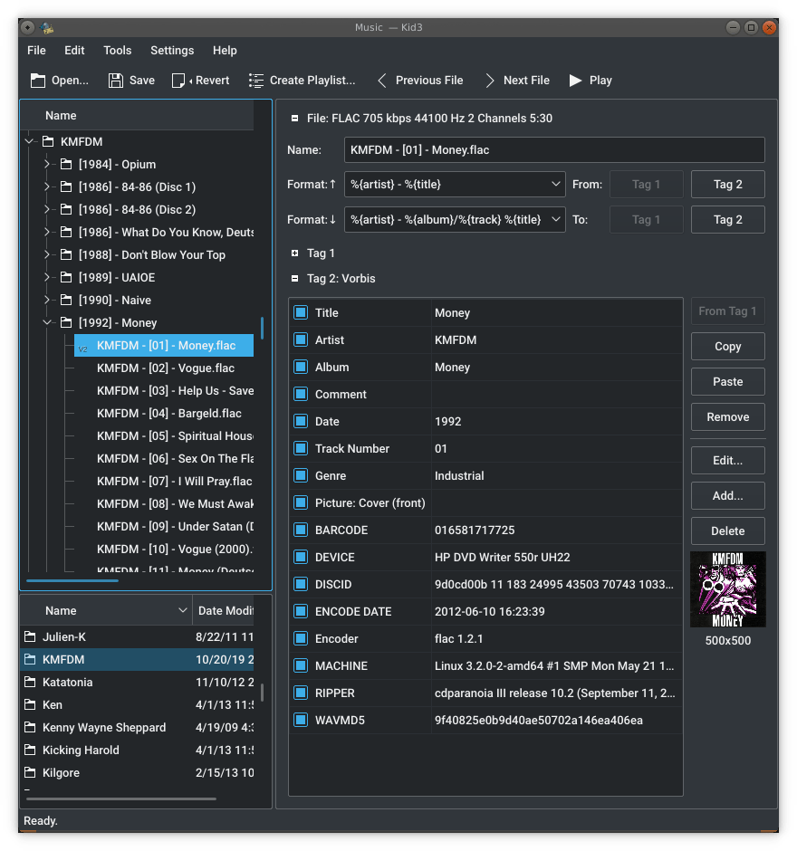

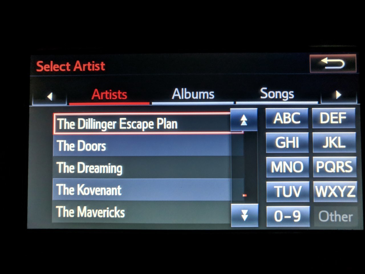

    Hi folks, I just joined this forum specifically to reply to this thread. I own a 2016 4Runner with Entune, and found this thread while researching alternatives to using my old iPod Classic 160 GB connected to Entune. As we all know, the iPod Classic is getting pretty old and mine has been having issues lately, so I wanted to investigate the possibility of using a large capacity thumb drive instead. Anyway, I wanted to reply to see if I can help some of you on here, and also see if some of my questions might be answered.
    First, I have read many of you complain about not being able to see all tracks, or having issues searching for music on a USB drive, etc. My suggestion here, and this is based on years of personal experience with portable music files, is that you must have your music collection very organized with a standard naming convention. This is paramount. I have over a TB of MP3 files on my PC on a separate hard drive just for my music collection, and everything is organized as such:
    M:\music\Artist Name\Album Title\Artist Name - Album Title - Track Number Leading 0 - Track Name.mp3.
    An example of this would be M:\music\Cure, The\Disintegration\The Cure - Disintegration - 04 - Lovesong.mp3 as below:
    A few things to note here. First, the FOLDER name for this band is "Cure, The". This eliminates having to scroll through tons of bands that start with "The" and gives you the ability to find the band you want much quicker. ***This only applies to searching on your harddrive, in Entune I think the "The" is automatically removed for ease of navigation. I do this in my folder structure on my hard drive, otherwise you will end up with a ton of folders starting with "The" and it's a pain to scroll through all that, if you have a massive collection as I do.
    Also note, this file, folder structure can be varied however you want, but it is important that ALL your music is named and organized in the SAME way. This will give your ID3 tagging program a standard file name to use when applying new ID3 tags. I know a lot of you are already shaking your heads because the answer is YES, this does take some work to organize and setup. I've been doing it for well over a decade, and it just depends on how important it is to you to have your music collection with you while you sit in traffic for 3 hours a day. For me, IT IS.
    Now, a quick lesson on ID3 tags. This is the method by which audio playback devices sort, read, and display track info, such as ARTIST NAME, ALBUM NAME, etc. Without proper, standardized ID3 tags on EVERY SINGLE FILE your digital music playback devices with have trouble reading the files in any sort of orderly fashion, making the use of said device(s) annoying and frustrating. So you NEED to have your ID3 tags standard too, which is why I suggest starting with standard files names. Once your file names are standard, you can use an ID3 tagging program to remove the old tag, and apply new tags based on your already standardized file names for your whole collection. (this is one of the things I *think* iTunes does for you, however I loathe iTunes and any sort of DRM software, so I avoid it, but if it works for you, cool)
    There are many programs out there, but I have always used a program called ID3-TagIT to apply STANDARD ID3 Tags to each track based on my STANDARD file naming convention mentioned above. This is what the properties of your files should look like if you were to set up your music like mine:
    Notice the fields for Title, Contributing Artists, Album and # are the only fields complete for my file. This is because my ID3 tags only contain this info. You can however add genre and other tags if it is helpful, but for me, simplicity is key. Also note, this is under the PROPERTIES of the individual MP3, under the DETAILS tab. You can directly edit ID3 tags via Windows this way, one file at a time, but I do not recommend that!!!
    So, using that method, I have NEVER had issues with Entune organizing my music in a very user friendly, searchable fashion. I think those of you on here who have issues have haphazardly organized collections that fail to have standard file names and possibly missing or broken ID3 tags. It is a lot of work to get your collection organized, but it is simple if you start from scratch using a CD collection, for instance. I can give more tips on this if some of you are interested, but the bottom line is, your music collection MUST be organized, standardized and properly ID3 tagged or you will have lots of annoying problems with not being able to find tracks, etc. The programs I have been using for over a decade now consist of CDex (for ripping CDs to my computer), 1-4a Rename (great program for easy bulk file renaming to a standard format) and ID3-TagIT (super easy, bulk ID3 tagger, which you need to do once your files and folders are organized and standardized).
    So, hopefully that info helps some of you, I can elaborate a bit for those of you who are not so tech savvy on any of these points, if needed.

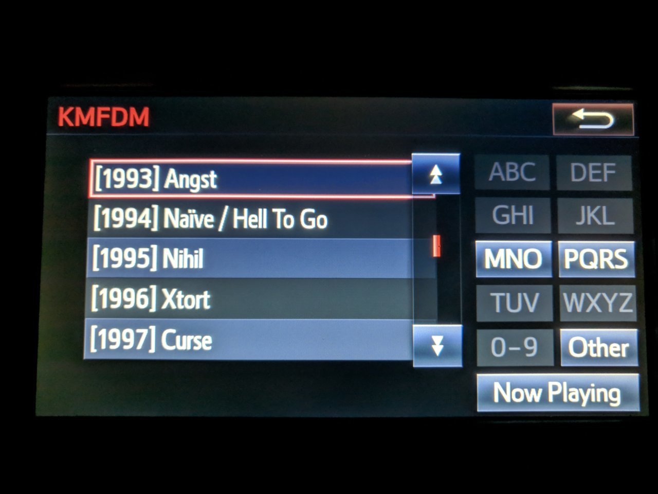

    1. I've tried many suggestions from here and other sources. 9,999 does indeed seem to be the limit.
    2. Partitioning doesn't work, however, Entune will read up to 2 thumb drives with a usb hub.
    3. With the exception of trying a usb 1.0/1.1 drive, the protocol seems to makes no difference.
    Like you, I'm very particular with my folder structure and tagging. Entune doesn't seem to sort albums chronologically even with proper ID3v2 (mp3) or atoms (m4a), so I've had to append the year before the album name on my usb drive. Also, Entune doesn't seem to account for "The" in artist names. So "The Cure" will appear that way on Entune.

    When you say chronologically, you mean you want to sort by release year and Entune does not recognize the release year in the ID3 tag? I've never bothered with tagging the release date on my music, I just have way to much I don't really worry about when a record was released, so alphabetical organization is preferred for me. I bet Entune only looks at certain tags and ignores all others. I only tag Artist, Album, Track Number and Track Name. Now that you mention it, I can't recall what Entune does with the "The", but it definitely ignored it on my iPod, and Entune just displayed what the iPod had going I believe. I need to go buy a 128 GB stick and load it up and do some testing. Worst case, I will buy two and one of the USB splitters and break my portable collection into two halves.
    I have a small 32GB drive in the T4R right now, and one thing I noticed is it seemed to work a whole lot faster than my old iPod Classic, but that is also likely because it is much smaller and it is solid state, as opposed to the iPod which still has a hard drive with seek time. I'm really hoping a couple thumb drives is an adequate solution for me. It will make loading and moving music around a lot simpler for me too, since I won't have to mess with 3rd party software like ML-iPod, iTunes or WinAmp to get music moved into the vehicle. Just Windows and I am good to go!
    Also, I don't see my favorite KMFDM releases there, kid. Where is UAIOE and Money? ;)
