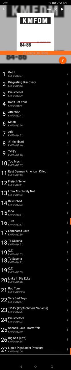

    84-86 is a 2 tape/disc set. I could send it your way if interested. It's in 192kbps mp3 though.

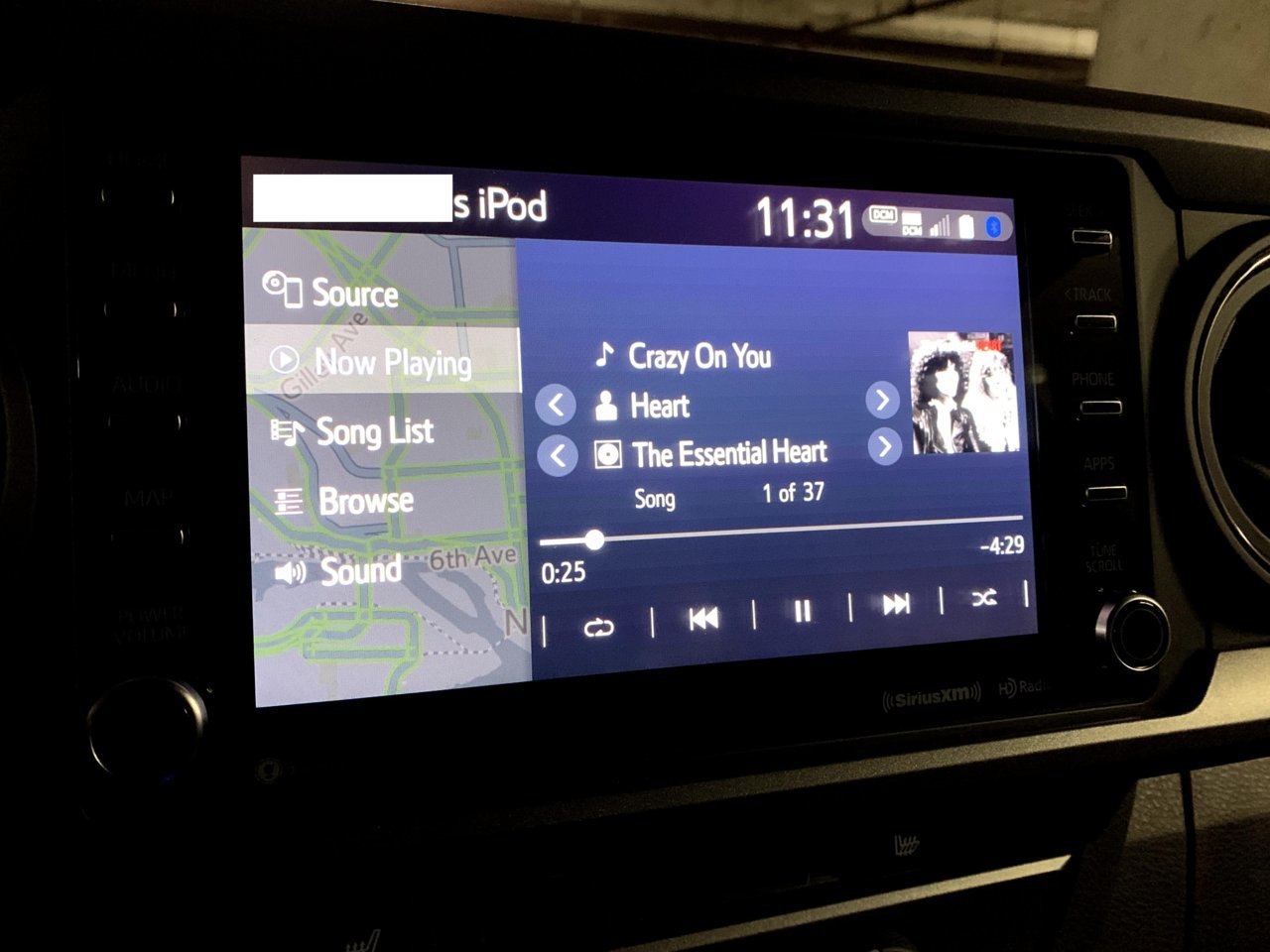

    Has anyone tried a refurbished iPod or had their iPod refurbished? I have an 80 gig iPod classic connected to my 2020 and it works. Slow but manageable. All track selection etc is done through the infotainment screen instead of the iPod. Took some getting used to after years in use with our prior 2003 Pathfinder.
    However, I was thinking it might be worthwhile to have it refurbished with a new battery and SSD of 1 terabyte. I would think it would be faster and longer lasting with a new battery. Most of my files are .flac but I do have a sizable .mp3 collection.
    Has anyone gone this route? Sorry if this has already been asked earlier. This guy (Remy Sternbach) does the upgrade. https://www.cultofmac.com/626220/1tb-ipod-remy-sternbach/ https://irefresher.com/
