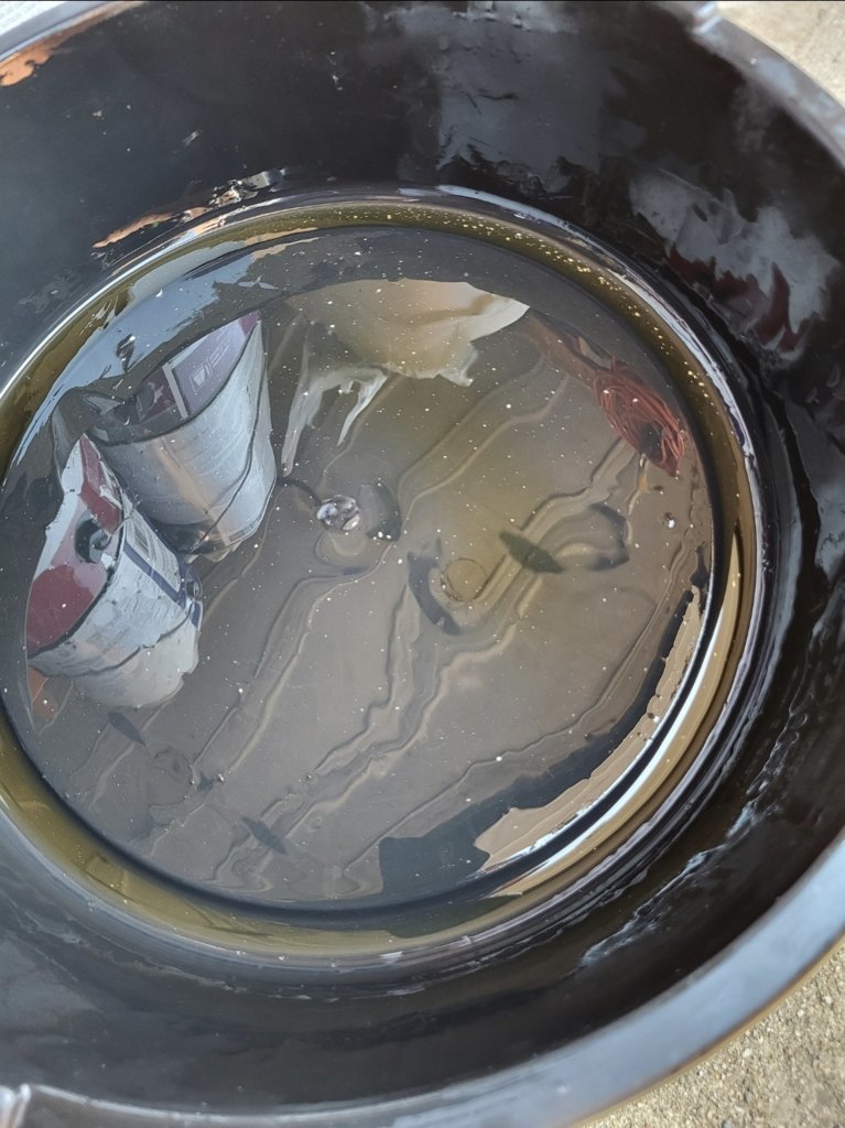

    Planning to change my manual trans fluid again this week~55k. This was what came out of my trans with the OEM fluid at either 25 or 30k (can't remember off the top of my head, too lazy to go check my log book in the truck right now).
    Lots of brass/bronze chunks, also some aluminum swarf. 2nd pic is the magnet on a stick I swirled alowly through the fluid before draining off most of the pan and taking stock of the metal left over. Luckily not a lot of steel. Will be doing this again when I change fluid. This time I'm going with motorcraft xtm5qs fluid, as its compatible and has good reports of being smooth in the manual.
    I think I changed it at 25k, early, because it was starting to feel notchy upshifting from 2nd to 3rd.
    marcamos[OP] and HondaGM like this.
